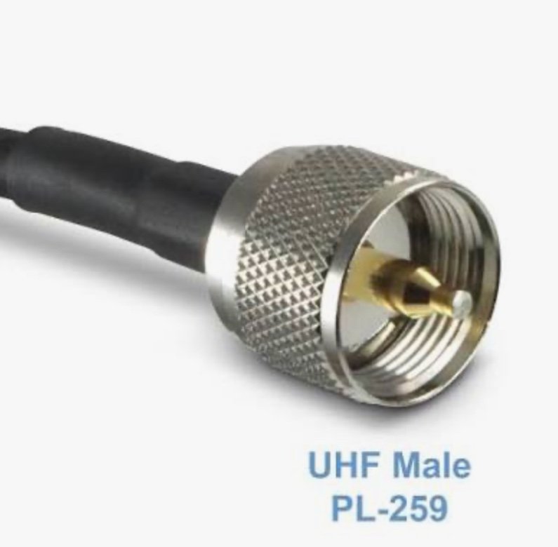

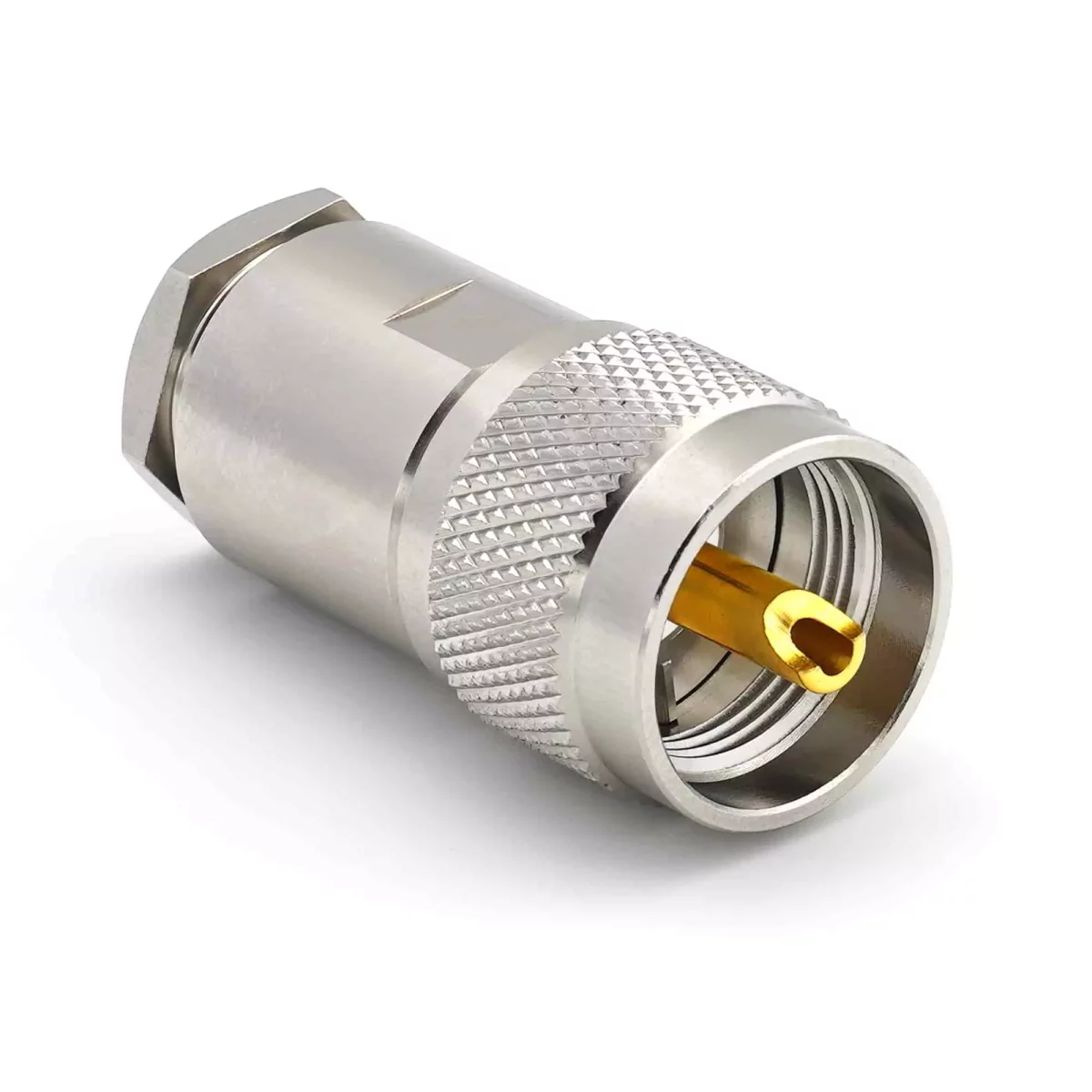

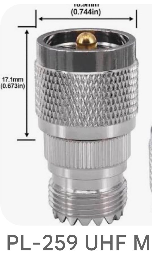

WSJW650 Posted September 13, 2025 Posted September 13, 2025 Looking at pictures of PL 259; some are more round, some are more pointy? Does it matter; or do all mate with SO239 equally? Quote
0 amaff Posted September 13, 2025 Posted September 13, 2025 And some are at an angle. It's the barrel of the connector that makes the difference, there's just different ways of securing the center conductor of the coax to that pin. If it's a PL-259 it'll work. WSJW650 1 Quote

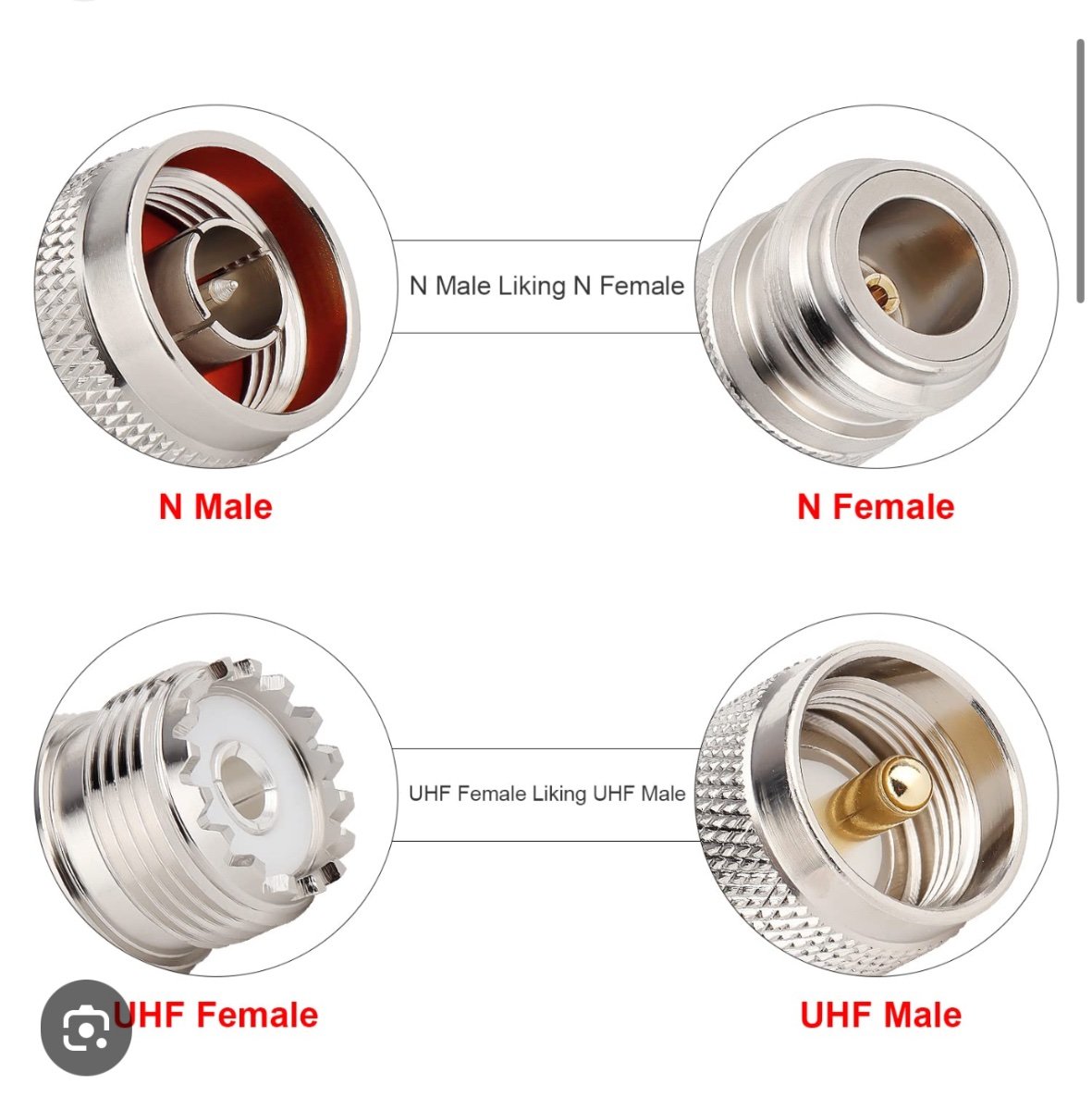

0 WRYS709 Posted September 14, 2025 Posted September 14, 2025 Not to be confused with the N UHf connector Quote
0 SteveShannon Posted September 14, 2025 Posted September 14, 2025 2 minutes ago, WRYS709 said: Not to be confused with the N UHf connector Even though the N connector is more appropriate for UHF than the SO239/PL259 combination, the PL259 is commonly referred to as “UHF connector “ whereas the N connector is not. Even in the illustration you posted the N connectors are not referred to as UHF. GreggInFL, WSEZ864 and WRUU653 3 Quote
