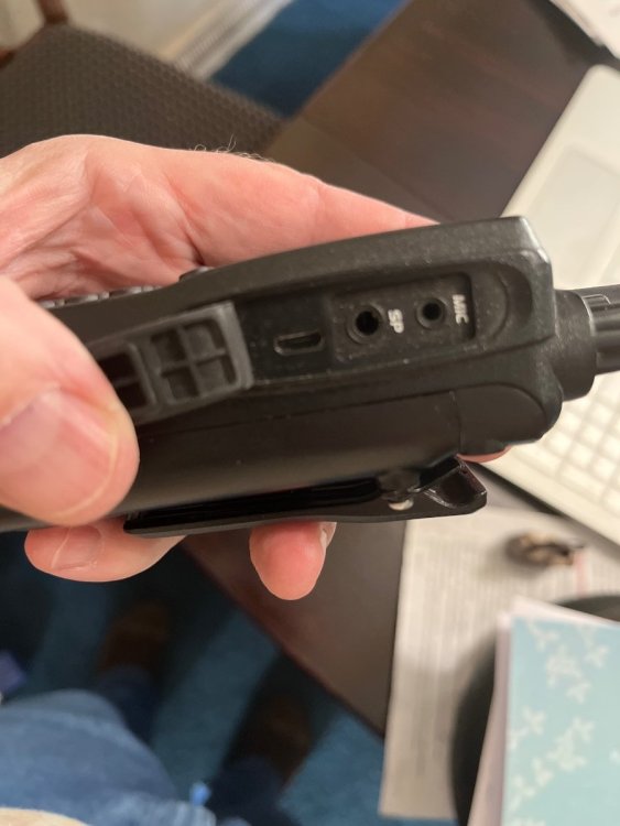

SteveShannon Posted September 22, 2025 Posted September 22, 2025 The major differences between the two handheld radios (Anytone 878 and Alinco MD5) that I have noticed are memory capacity for contacts (Anytone could store 300,000 call signs and names and Alinco could store 200,000 when I got my Alinco; both have increased since then), physical size (Alinco is shorter by nearly half an inch), price (Alinco was $70-80 less expensive), and interface cable (the Alinco simply used a USB A to USB mini cable, while the Anytone needs a K1 connection to the mic/earphone jacks). I don’t know how those features compare for the mobile radios. Quote

SteveShannon Posted September 22, 2025 Posted September 22, 2025 35 minutes ago, wrci350 said: Programming of both radios is done with a micro-USB cable. Steve, is the one on the MD5 really a mini? It is a micro USB, sorry. I get those two confused and until now I never have studied the difference. I apologize giving bad information. It’s the same as the power cord for my hotspot. Quote
