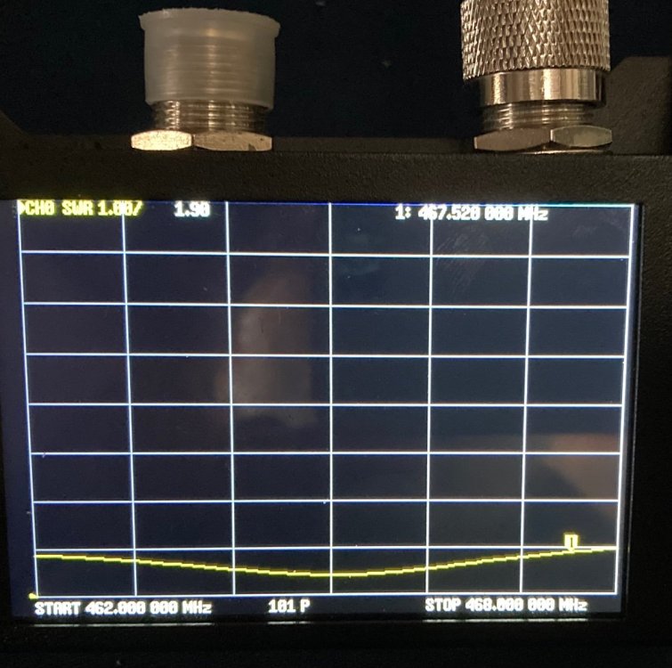

WSEF362 Posted November 25, 2025 Posted November 25, 2025 I have ham and GMRS radios and wondering what other ham antennas folks have found to work with acceptable results for GMRS. Today I checked my comet GP-9 with my nano VNA and found SWR to be less than 2:1 across the GMRS band. Tomorrow I will test my mobile antenna because inquiring minds need to know. Lscott and WRUU653 2 Quote

0 WRTC928 Posted December 4, 2025 Posted December 4, 2025 In my experience, more often than not, a 70cm antenna or 2m/70cm antenna which has a good SWR on 70cm will also have an acceptable SWR on GMRS. I consider anything below 2.0:1 to be acceptable. Similarly, if I get a good signal on 70cm, I'll also have a good signal on GMRS. I don't use a GMRS-specific antenna on either of my vehicles. WRUU653 and AdmiralCochrane 2 Quote
