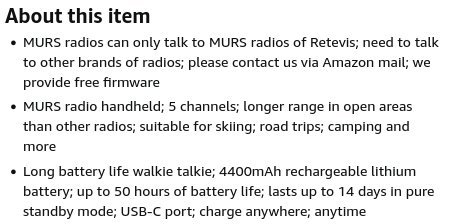

TNFrank Posted November 26, 2025 Posted November 26, 2025 I wanted a couple of actual MURS radios to use so I ordered a pair of RB17V radios. Retevis says that they'll only talk with other Retevis radios and if you want to talk with other MURS radios you need to install special firmware. I can't understand why since all MURS radios should TX/RX on the same 5 frequencies. The only thing I can think of is they have tone squelch set for TX/RX. I did notice that CHIRP lists this radio so when I get them I'm going to connect to it and look at the settings to see if they have ant CTCSS or DCS tones set. Does anyone have any info on these radios that they'd like to share? Quote

TNFrank Posted November 26, 2025 Author Posted November 26, 2025 I'll do one better. Here's a screen shot. Please read the 1st paragraph. SteveShannon and WRYS709 1 1 Quote
TNFrank Posted November 26, 2025 Author Posted November 26, 2025 I just checked my radios in CHIRP and there's no CTCSS/DCS codes set so I guess I'll have to try them on one of my other radios that I have programed with MURS frequencies. I'll report back on what I find out. OK, just to update, I checked the RB17V TX/RX on my UV-5R Mini that I have MURS on(for emergency use only, of course) and it worked just fine. I guess whatever they were doing they've stopped doing which makes sense because it'd be crazy to only allow YOUR radios to talk with ONLY your radios. Now if I can just figure out how to make the side button do the scan function. Quote
