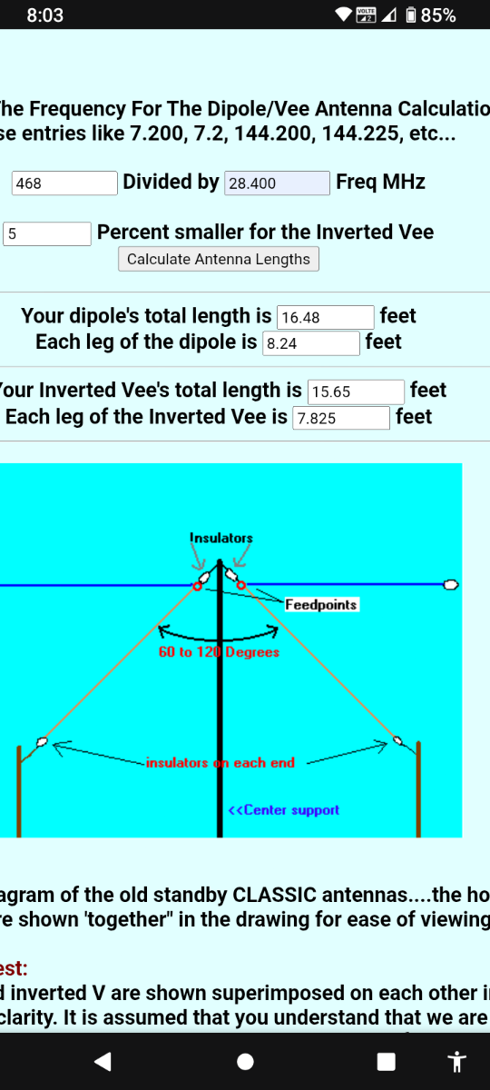

TNFrank Posted January 8 Author Posted January 8 Also remember that an Inverted V dipole will have shorter wires than a horizontal one. RoadApple 1 Quote
