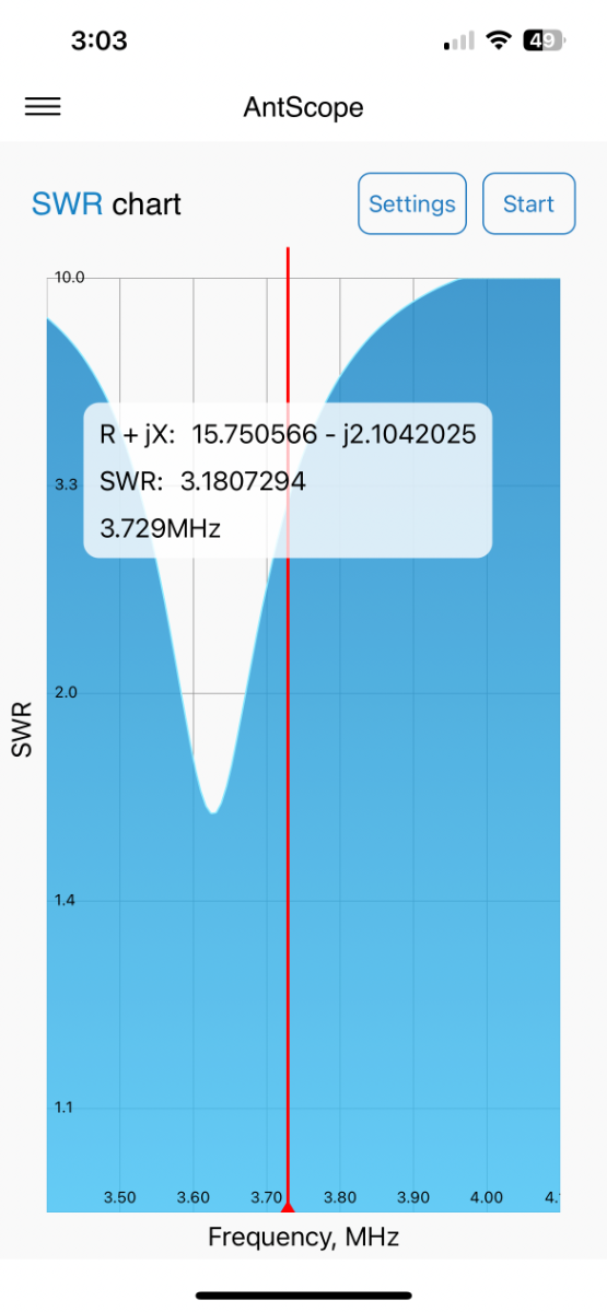

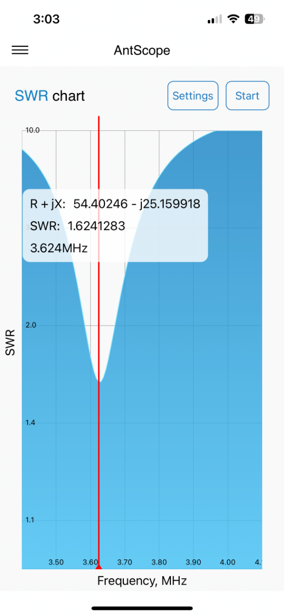

SteveShannon Posted January 7 Posted January 7 25 minutes ago, TNFrank said: So, why wouldn't something like this work to tune an HF antenna? I could hook it between the radio and antenna coax and check the SWR then adjust the antenna as needed to bring the SWR into the proper range. https://www.amazon.com/s?k=swr+meter The NanoVNA shown on that page would work, but the Surecom swr meter tells you nothing about which way or how far you need to adjust your antenna, which is what an SWR sweep on an analyzer shows: WRUU653 and WRYZ926 1 1 Quote

WRYZ926 Posted January 7 Posted January 7 1 hour ago, TNFrank said: But it would tell me the SWR and I can tweak the antenna a bit until I get the SWR to where I want it AND it's much simpler for me. I had a NanoVNA and I didn't like it because it was too complicated for me even with watching videos. I want/need something simple and basic, not something fancy and complicated. A SWR meter will only tell you what the SWR is at the frequency you are transmitting at when taking a reading. It will not tell you if the antenna is short or long. Yes you can use a SWR meter by transmitting at the lowest frequency you can use and again at the highest frequency you can use. But it still won't give you a very good idea if the antenna is short or long. That is why we keep recommending a NanoVNA or antenna analyzer. They will show a sweep across the entire band so that you know exactly if the antenna is short or long. Even with the learning curve of a NanoVNA, it is still way easier to tune a HF antenna with one. Another advantage of a NanoVNA and Analyzer is they will also show what the impedance of the antenna is. Plus you can also test your coax with them too. Sometimes trying to save money is NOT worth the headaches and aggravation it may cause. Splurge on a NanoVNA or antenna analyzer. You will thank us in the long run. PS: You might have your antenna perfectly tuned for your home but it could be way off at a different location based on the soil conductivity. And this can cause the antenna to need retuned. We really are trying to help you save yourself some aggravation by repeatedly telling you to get a NanoVNA or antenna analyzer. hxpx and SteveShannon 2 Quote

hxpx Posted January 7 Posted January 7 Your method will work, but showing the SWR sweep makes it easier to know where the dip is and if cutting off more wire is going to make things worse. Something like a RigExpert AA-35 might be easier to use but they cost way more than a NanoVNA, which is why everyone recommends them. My NanoVNA is basically a glorified SWR meter at this point. Turned off all the traces except Trace 0, set it to read SWR, and the set the sweep start/stop to the band I want. I hate the twitchy touchscreen and I can't get it to save settings - maybe I'll get a RigStick at some point or at least learn what that swirly Smith chart means, but for now it does what I need it to do as far as cutting wire or adjusting a vertical goes. WRYZ926 1 Quote
