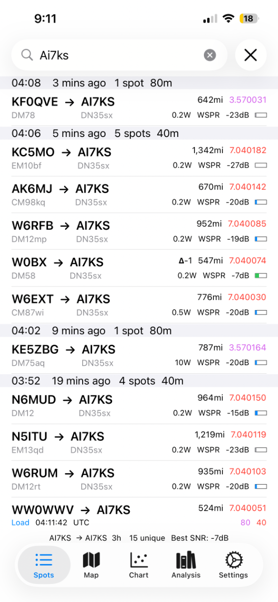

SteveShannon Posted January 15 Posted January 15 And here’s a look at the spots in data format. I only received tonight: Quote
