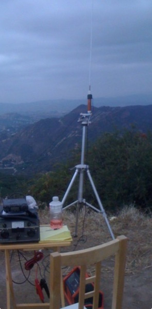

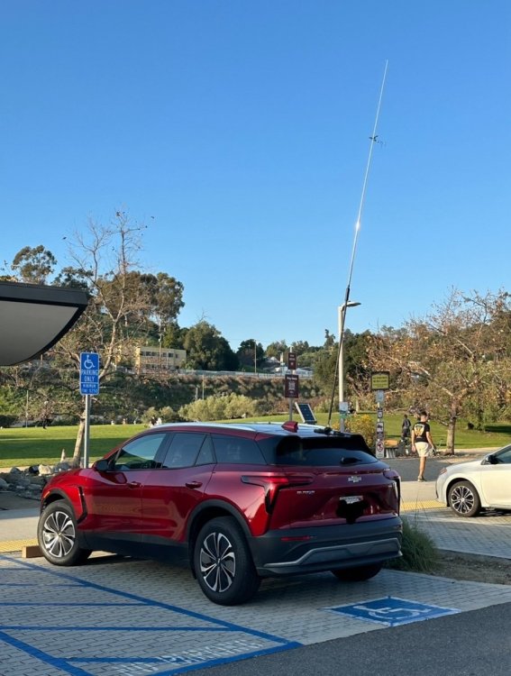

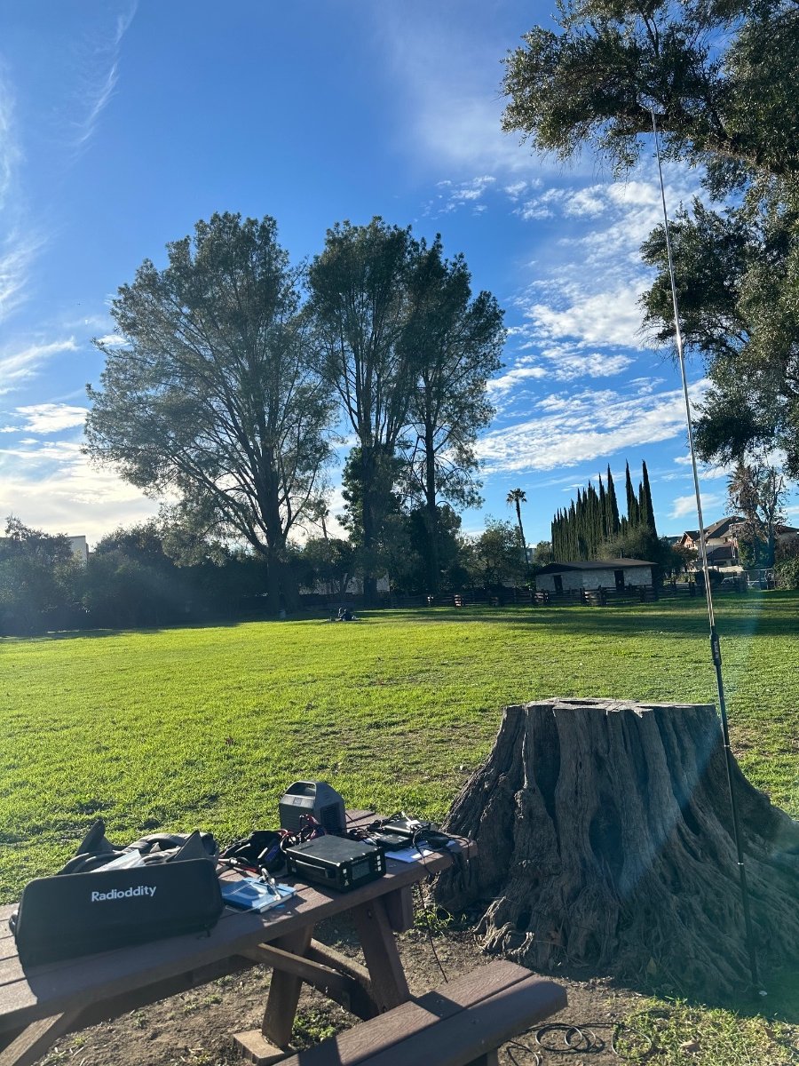

0 SteveShannon Posted January 24 Posted January 24 6 hours ago, WRYS709 said: Currently a "bundle" is on sale at Radioddity for $159 with everything you need to get on the air: https://www.radioddity.com/products/radioddity-hf-009?srsltid=AfmBOoqMMP1c2amRuw9WVYaQSz8HriH4OnTwbLxaSJgwRPHhucBftGeM Here it is being used with its spike in the ground: And here it is with the Base and Triple Mag-Mount from my Radioddity HF-008 used to elevate it on the roof of my stationary SUV: Blue was when using the Spike and Red was elevated on the triple mag-mount last Sunday and Tuesday, respectively, on 20 meters QRP SSB and FT8 (as it got dark I added one SSB on 40 meters): It has a weather protected coil mechanism with gradation markings that can be used to remember where the coil should be approximately set for each band. @WRYS709, what’s your ham call sign? I’ll add you to my grid tracker alerts for ft8. Thanks! Quote
0 WRYZ926 Posted January 24 Posted January 24 Steve is spot on. Anytime you use a coil, the antenna will be narrow banded. Same goes for multi band antennas that use traps (inclosed non adjustable coils). These type of antennas with adjustable coils will be more narrow banded as the frequencies get lower. IE they will be more narrow on 20m - 40m compare to 10m - 12m. Now for radials. The HF-009 only comes with 3 radials and the base only has 3 holes for the 3mm banana plugs. The more ground radials you have the more efficient, and easier to tune, the antenna will be, My suggestion would be to get some 3mm banana plugs and some 18 gauge silicon wire to make Y splitters. That way you can add more ground radials. I did the same for my REZ Recon antenna and it does improve the performance of the antenna. Radial length doesn't really matter when it comes to ground radials. If you decide to elevate the antenna and radials then you will have to cut/tune the radials for the bands you are using. I will echo what Steve said about needing an antenna analyzer, NanaVNA, or a radio with a good SWR sweep function when using a telescoping whip antenna. You can't go strictly by measurements of the whip as it will change depending on location and soil conditions. This is a must when using these antennas. The Radioddity HF-009 does seem to be a poplar portable antenna that works well. I would not hesitate to get one if I did not already have the REZ antenna system. SteveShannon 1 Quote
0 WRYS709 Posted January 25 Posted January 25 18 hours ago, WRYZ926 said: Steve is spot on. Anytime you use a coil, the antenna will be narrow banded. Same goes for multi band antennas that use traps (inclosed non adjustable coils). These type of antennas with adjustable coils will be more narrow banded as the frequencies get lower. IE they will be more narrow on 20m - 40m compare to 10m - 12m. You say "narrow banded" as if there is something wrong with that?!? 18 hours ago, WRYZ926 said: Now for radials. The HF-009 only comes with 3 radials and the base only has 3 holes for the 3mm banana plugs. The more ground radials you have the more efficient, and easier to tune, the antenna will be, My suggestion would be to get some 3mm banana plugs and some 18 gauge silicon wire to make Y splitters. That way you can add more ground radials. I did the same for my REZ Recon antenna and it does improve the performance of the antenna. You are spot on here: HOA Ham has a good YT video going into more detail about what to buy to make these improvements and my order from Amazon with his suggested items is due to arrive this upcoming week: I plan to add a 3mm Banana Plug to 4mm Banana Jack adapter or just use that huge clip to handle all my different antennas. 18 hours ago, WRYZ926 said: I will echo what Steve said about needing an antenna analyzer, NanaVNA, or a radio with a good SWR sweep function when using a telescoping whip antenna. You can't go strictly by measurements of the whip as it will change depending on location and soil conditions. This is a must when using these antennas. The Radioddity HF-009 does seem to be a poplar portable antenna that works well. I would not hesitate to get one if I did not already have the REZ antenna system. Although I did buy a nanoVNA and I keep it in my Radioddity HF-009 bag, I find that my instincts are good enough to work around having to use it, if I want to save time, since I always have an antenna tuner with me (either my CCT: the Antuner AT-100M Pro; or the one built in to my Xiegu XPA125B amplifier, which I often use QRP just as a tuner). It's real simple: I tune my Xiegu G106 to the FT8 frequency on the band I want to transmit, turn up the volume, and slide the tuning coil's adjustment knob up and down until I arrive at the loudest sequels of delight from the FT8'ers! I am then close enough to use my Antenna tuner to compensate for the rest! At some point when the excitement of using new toys has diminished a bit, I will whip out the nanoVNA and use a Sharpie to make marks (and note in my log) the two portions of each band that I want to tune to: FT8/FT4 and SSB. Today I did another park Activation on 20 meters, since the HF-009's coil was already tuned for 20 meters and again put it on top on the HF-008's PL259 base to 3/8x24 so that the HF-009 was elevated to the roof my my SUV with the HF-008's triple mag-mount: I straddled 4pm again so that I Activated this Park on two separate days with both FT8 and SSB QRP; and when I wanted to experiment on 40/80 meters as the sun was going down, the Park Rangers threw us out as it was closing time! So I found another POTA park 15 miles away, had some dinner and drove over, as that park's closing time was 9pm! I took down the HF-009 and installed my MFJ-1880 80 meter telescoping HT-style whip (originally sold as an adjunct to the wonderful Yaesu FT-817 Shack in a Box QRP battery powered rig; and HRO had one on sale that I could not resist)! Again I instinctively got it down to 1.5:1 SWR by dropping the lowest most section and a bit of the next one and the tuner got it to 1.3:1. Sure enough the Rangers threw us out at 9:10pm and I had just hit my 11th FT8; one more than needed to Activate this Park! I did try earlier to use my Xiegu XPA125B as an amplifier with my Xiegu G106 and I got a call back that my audio was crap due to RF bleeding into the transmission somehow, a la @Northcutt114's problems with his G90! I managed to find myself on the Northern Utah WebSDR and I could hear the problem. So today was again, all QRP. Strange as this Amp does not bleed into my other non-Xiegu QRP radio and they work fine together. Some research is due here, or I just will bring both rigs in the future to mix QRP with QRO work! FUN WITH QRP - FT8 and SSB from two separate Park Activations: Northcutt114 1 Quote

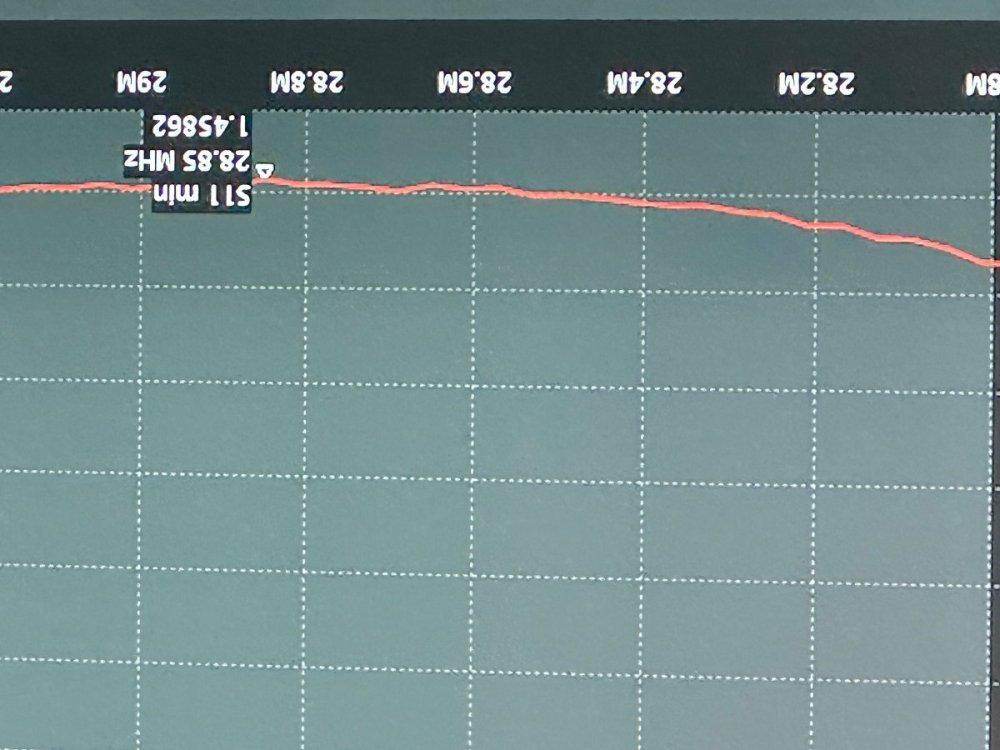

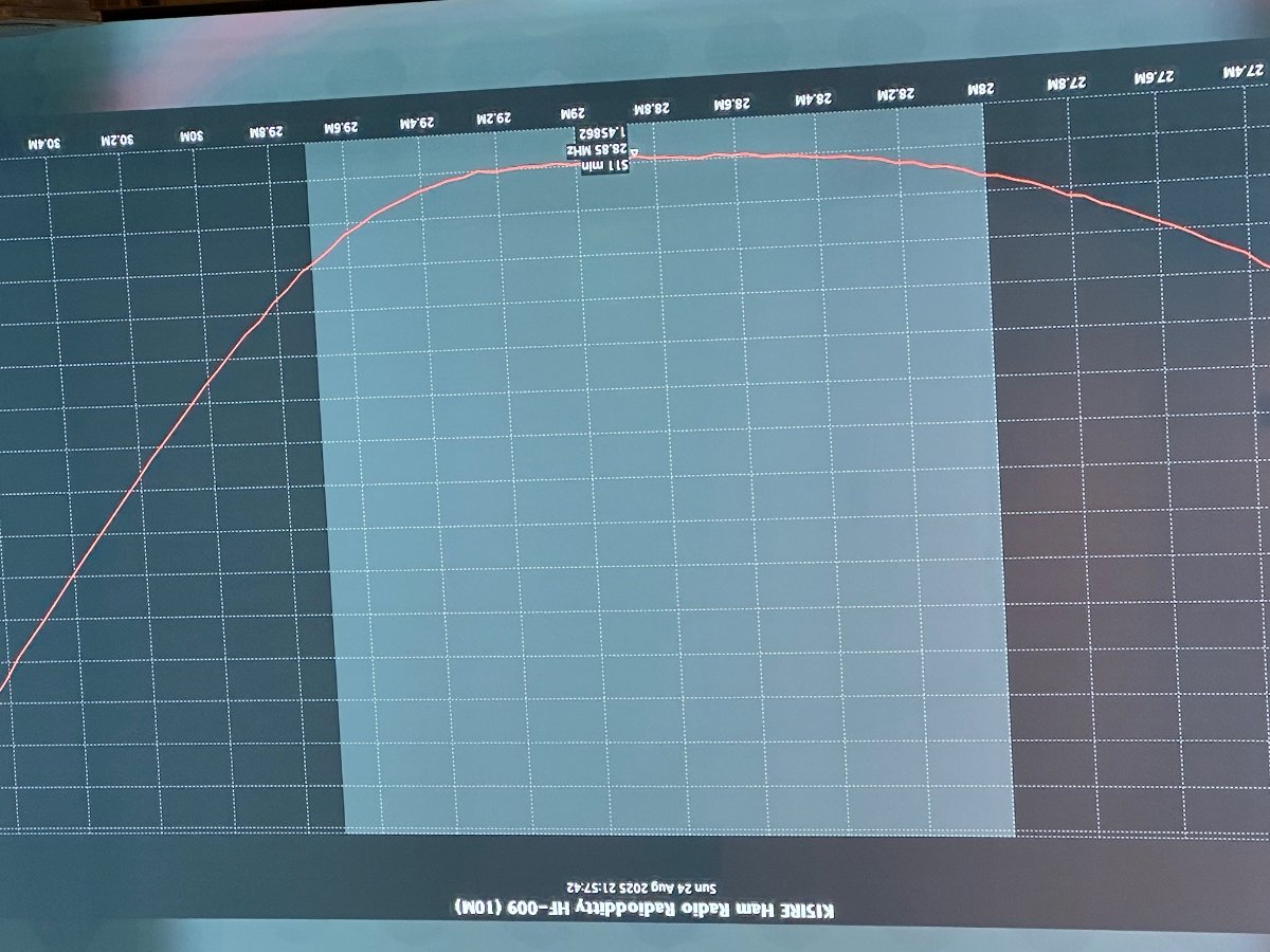

0 WRYS709 Posted January 25 Posted January 25 This guy, Ham Radio HQ, at 12:49 into his YT video finds a relatively flat SWR across your portion of the 10 meter band. Consistent with the advice above on the higher bands i don’t know why this is pasting upside down! SteveShannon 1 Quote

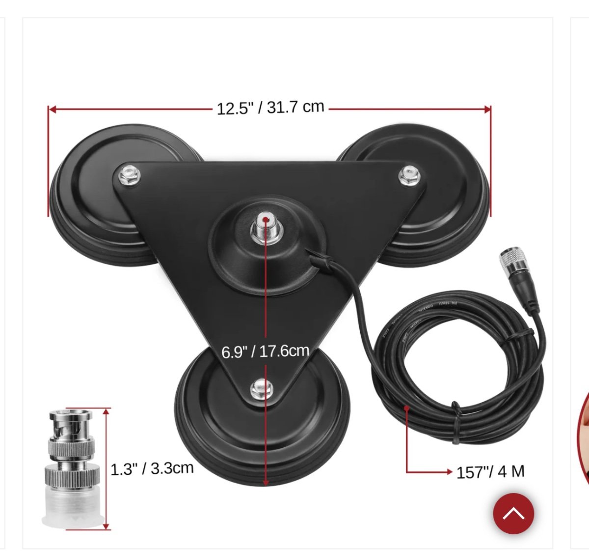

0 WRYS709 Posted January 26 Posted January 26 32 minutes ago, WRYZ926 said: Yes elevating a 1/4 wave antenna has its advantages and it will work better. The down side is that you absolutely need to tune not only the whip but you also need to tune the elevated radials also. That’s another advantage of using the 3/8x24 to PL259 base from the HF-008 to their Triple Mag-Mount on my roof: no radials Quote
0 WRYZ926 Posted January 26 Posted January 26 8 minutes ago, WRYS709 said: That’s another advantage of using the 3/8x24 to PL259 base from the HF-008 to their Triple Mag-Mount on my roof: no radials The reason you don't need to use radials is the fact that your vehicle's roof is acting as the ground plane/ A SUV or van roof will work much better than a single cab truck roof. If setting up an elevated 1/4 wave vertical as described in the KB9VBR video you linked above, then one absolutely needs to tune the elevated radials. Quote
0 WRYS709 Posted January 26 Posted January 26 2 hours ago, WRYZ926 said: If setting up an elevated 1/4 wave vertical as described in the KB9VBR video you linked above, then one absolutely needs to tune the elevated radials. KB9VBR is discovering the benefits of using the HF-009 freed from its Spike Mount. But he doesn’t realize the abilities to use it mated to a Pl259 to 3/8x24 base and mounting it on a triple mag-mount instead. Especially once he realizes the financial benefits of buying those parts as part of a Radioddity HF-008 Bundle and getting 80 meters thrown in as part of the deal! This 008 Bundle, when offered, is only $99. Amazon sells the Gabil 3/8-24 to UHF PL-259 Antenna Adapter - AD-35 for $26 and the Heavy Duty SO239 Magnetic Antenna Mount Base with Triple Magnets for $39 Its like getting the Radioddity HF-008 3.5-50 MHz antenna for only $35 more! Quote

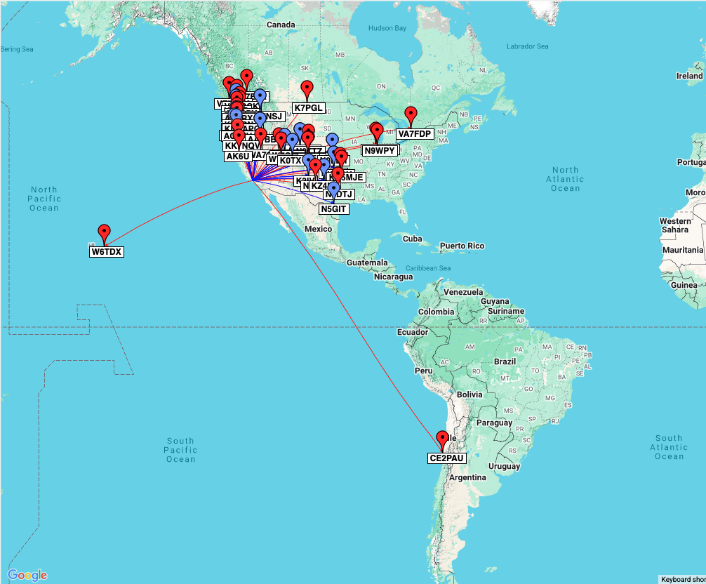

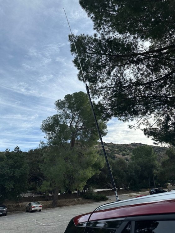

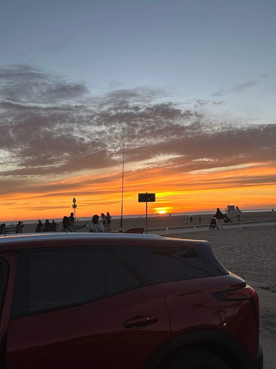

0 WRYS709 Posted January 28 Posted January 28 Tough spot for a Late Shift POTA Activation tonight on 20, 40 and 80 meters. I used the Radioddity HF-008 on 80 meters and was able to quickly switch from my 20 meter and to my 40 meter telescoping monobander whips from Thailand. The Thai-Whips tune easily once you know how long to extend them for the SSB and FT8 portions of their respective bands, and they like the Triple Mag-Mount as a ground plane! Both 80 and 40 went dead about 23:00pm PST. Quote

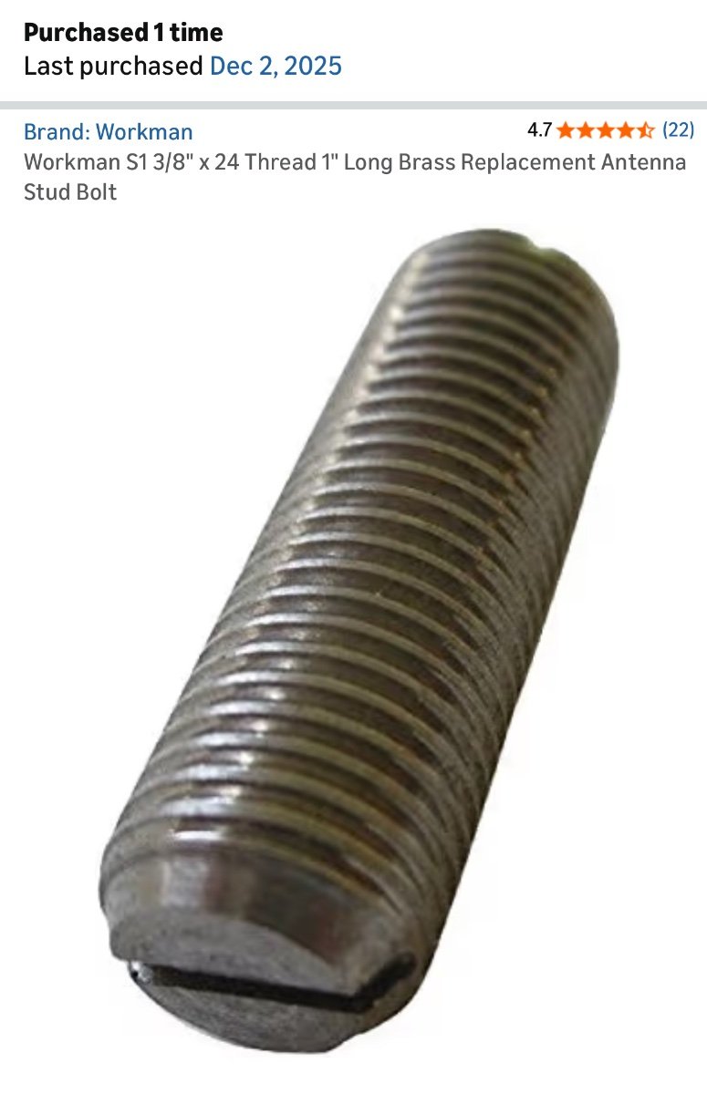

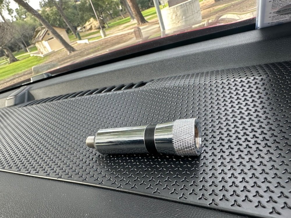

0 WRYS709 Posted January 28 Posted January 28 Remember: you will need this 3/8x24 stud: https://a.co/d/bJX0RQI if you want to swap out the Spike for another mount They are cheaper at your local hardware store. If the substituted base has an Allen Screw, do not over-tighten as that may damage the threads. Quote

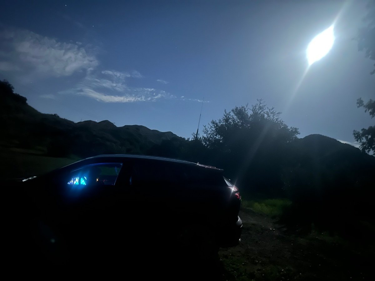

0 WRYS709 Posted February 2 Posted February 2 Late Shift Activation under the Full Moon here using the Radioddity HF-008 for 80 meters FT8 & SSB and about to switch over to the Thai-Whip for 40 Meters for more FT8. 40 was dead to SSB! Quote
