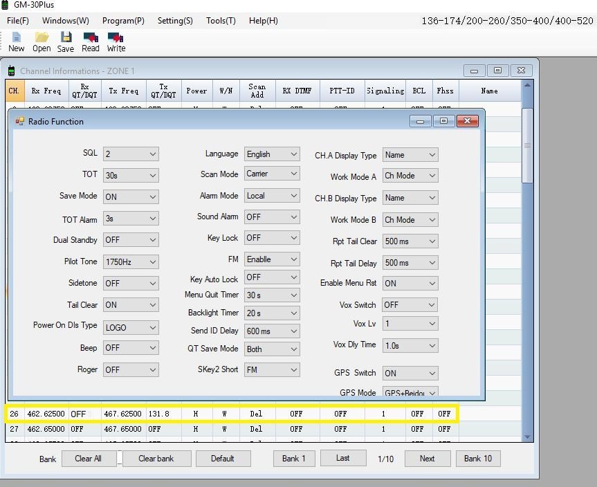

I've read the thread and followed the suggested steps, however I have two radios so I know if Tx is working and still the only Rx and short blip of Rx is the tail. I'm hoping someone can check my math and tell me how badly I botched the programming. I've read to keep the Rx Tone off. My desire is- find a repeater where I am or where I may travel and be able to program it in. Here are screenshots of a repeater in my area and how I programmed them on Channel 26 and it isn't working. Thanks for any input!
