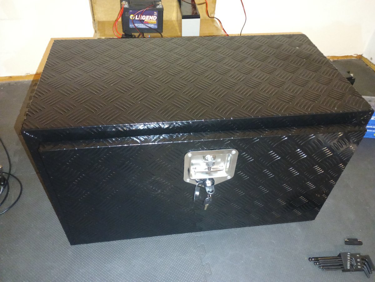

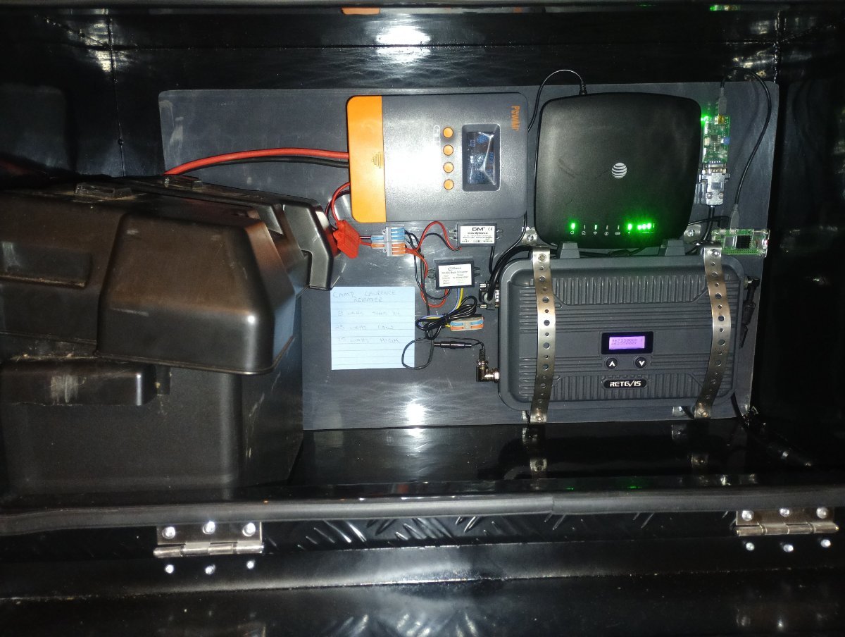

 Solar powered GMRS Repeater set up for off grid communications in UP Michigan.
Items included -
powmr 45amp MPPT solar charge controller -$50 ebay
4 - 100watt eco worthy solar panels -$50 each =$200 total ebay
Retevis RT97S - $350 amazon
Raspberry pi /case -$50 amazon
Att 4g Hotspot - $50 ebay 4g service not included
Retevis GMRS Base Antenna -$70 amazon
12v 100ah self heating Lifepo4 Battery -$220 amazon
say $1000 -$1200 when your all done with wires and brackets to set up everything
comms will cover 5-10 miles easy
runs 24/7  365
8watts in stand by - 25watts tx low power - 35watts tx high power
(raspberry pi and hotspot are optional for controller)
you only need the solar charge controller,  repeater, antenna,  battery, and solar panels to make it work
with this set up it will use this many watts per hour
3watts  in stand by
20watts tx low power
30 watts tx high power
