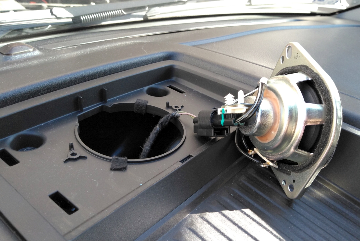

I'm not sure of speaker placement on the Ranger, but I've seen a few options on the F150 that might work for you:
1) If there is a center channel speaker in the dash above the infotainment system, disconnect it and use it as the speaker for your radio. Can be seen here: full
2) Get a remote speaker and place it behind the infotainment system, within the dash. This can be seen here: http://i.imgur.com/ZiKiesy.jpg?1

@tweiss3 That may be the simplest option. My XLT doesn't have a speaker there, but I'd bet if I pull that trim piece up there is a mounting location, should just need to buy the Lariat trim speaker and cover. Time to start looking for that, maybe they are not on back order. I already ordered one dash trim panel I'm cutting up and test fitting the KG-1000G face plate on.
Update: looks like about $130 for the grill, speaker and speaker plug from Ford. The path I was going was at about $160.
