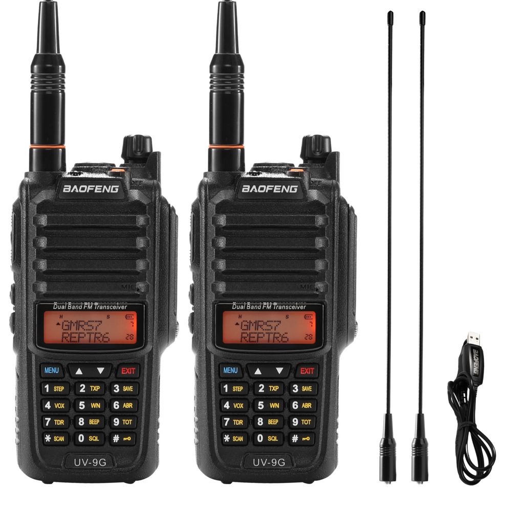

Oops by the way.. I almost forget that I need to buy 2 GMRS handheld radio. Because our old walkie-talkie dies not too long ago.  Are there any GMRS hand held radio that I can buy that that is not that expensive like around 100 bucks for 2 of them? Honestly we dint use our old radio besides emergency or she's inside the grocery. what do you think about this one?
lQLPJxaCZpLra83NBkDNBkCw549OYXRst7EC1rb71wBUAA_1600_1600_1024x.png?v=1658199542
