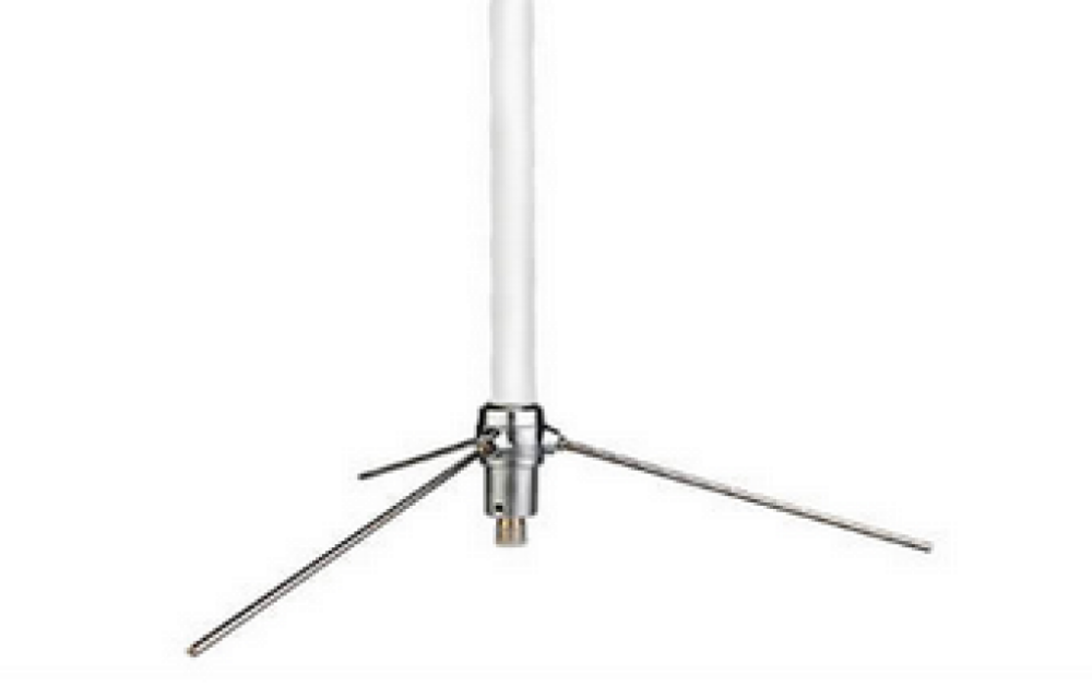

LeoG Posted June 10, 2024 Author Posted June 10, 2024 So it made my performance much worse? Right now I don't have a physical ground. It's a metal building, metal mast with a metal support. Not sure if the side of the building actually has ground contact in any manor but I'm betting it does. I was using the ground plane as my ground until I get the setup permanent at which point the system was going to get it's true ground. Quote

LeoG Posted June 10, 2024 Author Posted June 10, 2024 Ya, I know. Just doing what I can with what I have. No idea on how the MA-09 is setup and I really have no idea if it's a J pole style antenna or not. It definitely looks like a short as I am reading resistance that looks to belong to 50' of wire. But it's also not really steady, jumps around a bit - there is wind out there. So I guess this means I'm back to square one, not knowing a darn thing LOL. Quote
SteveShannon Posted June 10, 2024 Posted June 10, 2024 10 minutes ago, LeoG said: Ya, I know. Just doing what I can with what I have. No idea on how the MA-09 is setup and I really have no idea if it's a J pole style antenna or not. It definitely looks like a short as I am reading resistance that looks to belong to 50' of wire. But it's also not really steady, jumps around a bit - there is wind out there. So I guess this means I'm back to square one, not knowing a darn thing LOL. Do you have a different piece of coax to try? Quote
