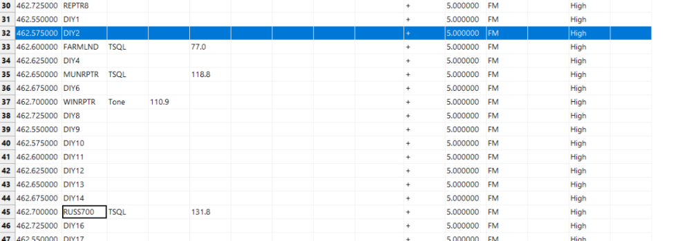

dosw Posted July 20, 2024 Report Posted July 20, 2024 43 minutes ago, WSDQ761 said: Thanks very much for the info. If you are who I think you are, I'm a fan of your channel! I am using a UV-9 G baofeng, so does it matter if it's tone or tsql? I have a saved radio file I think I might have right then. One has only a tx tone the other two has tx/rx tones listed. those both need put in if it has two correct? I will try and figure out how to get a screen grab and post a pic of the setup if possible. I'm just trying not to mess things up or make people mad! Im sure I can figure it out, I'm also into the drone and FPV hobby and I figured that stuff out just well enough. Within CHIRP: Tone means you transmit with the repeater's PL/CTCSS tone, which you must do for the repeater to listen to you. TSQL means you transmit with that tone, AND only listen if the repeater is transmitting that tone, too. With "tone" the repeater will hear you, and you will hear the repeater plus anyone else transmitting on that channel: Kids playing walkie talkie, road crews, whatever is being transmitted on that channel. With "TSQL" the repeater will hear you, and you will hear the repeater. You won't hear everyone else who happens to be intermittently using that frequency. For getting things set up the first time as a newbie, "tone" leaves one less possible problem in hearing the repeater. Once you've gotten set up and made contact once to confirm you have the right tone, switch to TSQL so you don't hear unwanted chatter. Raybestos and SteveShannon 1 1 Quote

KevinJ Posted July 21, 2024 Author Report Posted July 21, 2024 This is the current setup I have made that I have yet to try. Any input is appreciated! Quote
KevinJ Posted July 21, 2024 Author Report Posted July 21, 2024 On 7/19/2024 at 9:23 PM, dosw said: Within CHIRP: Tone means you transmit with the repeater's PL/CTCSS tone, which you must do for the repeater to listen to you. TSQL means you transmit with that tone, AND only listen if the repeater is transmitting that tone, too. With "tone" the repeater will hear you, and you will hear the repeater plus anyone else transmitting on that channel: Kids playing walkie talkie, road crews, whatever is being transmitted on that channel. With "TSQL" the repeater will hear you, and you will hear the repeater. You won't hear everyone else who happens to be intermittently using that frequency. For getting things set up the first time as a newbie, "tone" leaves one less possible problem in hearing the repeater. Once you've gotten set up and made contact once to confirm you have the right tone, switch to TSQL so you don't hear unwanted chatter. Okay, thanks a lot for that explanation and tip. I must have had a case of stupid the first time I read this because I didn't get any lights coming on from it, but as I re-read it late at night for some reason this time it made sense! I will modify the saved file I have and give it a try. Thanks again! WRUU653 and SteveShannon 2 Quote
KevinJ Posted July 23, 2024 Author Report Posted July 23, 2024 I just wanted to say thanks to everyone! I had my first successful repeater hit today! I was on a BF UV-9G on the ground from Mt. Summit, IN, and hit the Muncie Repeater! HUZAHH!!!!!! JBRPong, WRUU653, WRXR255 and 1 other 4 Quote
