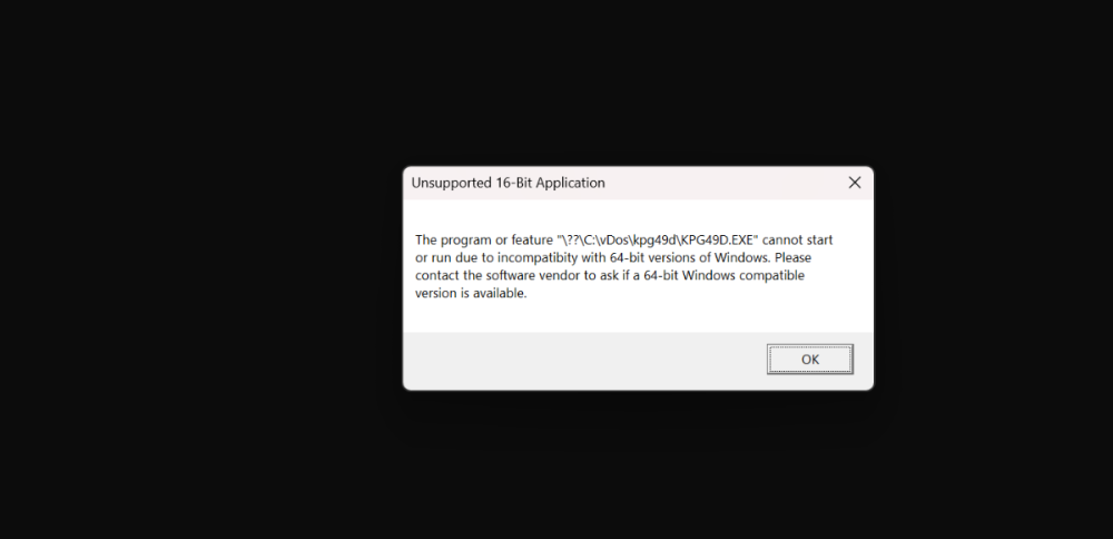

I am trying to program a radio that was given to me by a coworker and i can not get the software to work on windows 11. if any one has ideas i would love to hear them. i have the whole unit, mic, antenna, and program cable. i am using KPG-49D for a Kenwood TK-880 and it will not load the program on my windows 11 laptop.

this is a screenshot i have of the issue if it helps
You downloaded the 16-bit version of the app, the "DOS" version of the app, which is not compatible with Windows 10/11.  You'll need to get a hold of the Windows version of the KPG-49D software.

Thank you all for the help after alot of confusion and going half bald, it was the program and i have a working program and was able to program the radio.
