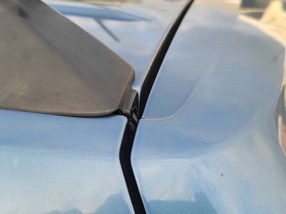

WSEN940 Posted March 20, 2025 Posted March 20, 2025 I scoured the net and found that the general consensus is that there are few ways to get an antenna into the cabin of a Subaru without inflicting some damage to grommets, bulkheads and the like. Just for reference, I did discover that above the wiring grommet on the passenger side front door there is a bung. It sits below the upper hinge and above the wiring harness. I popped it off and shoved an inspection camera snake in there and found that there is also a hole into the cabin about 2" below it. Mine was partially obscured by insulation, but, with careful work with the inspection camera snake, I managed to get it in behind the glove box. I won't go into all the gory details, but this turned out to be a really great way to get cable access. I now have a Ghost antenna mounted on a ditch light mount on the passenger side and it's cable runs neatly through the fender into the hole. I mentioned in a previous post about using the DB20-G for when we road trip together in the two cars, now, I can drop that into my lady's rig when needed and it's a clean plug and go! No mag mount and dodgy wiring needed. Hopefully useful info for folks that are considering routing options for the Subaru. WSDM599 1 Quote
