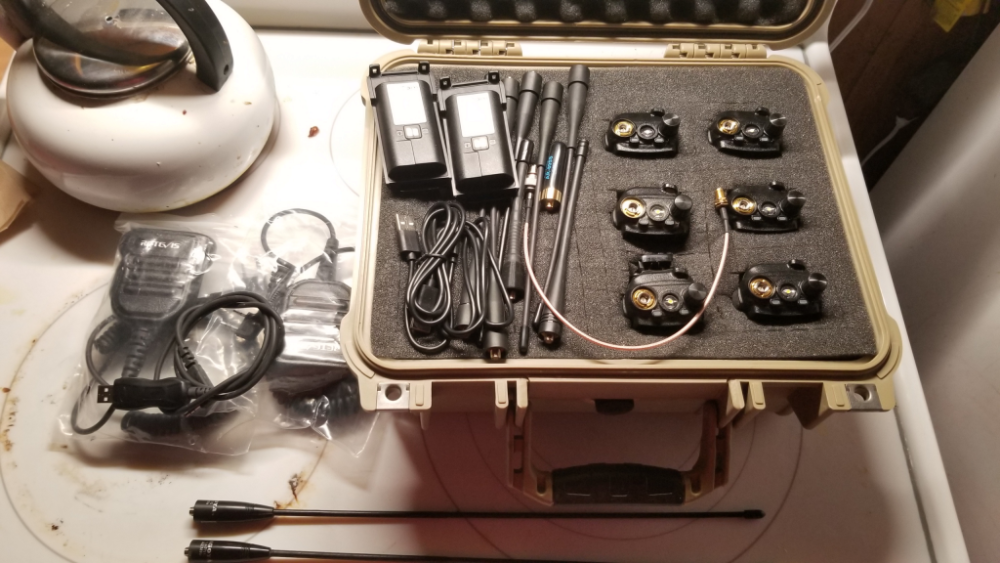

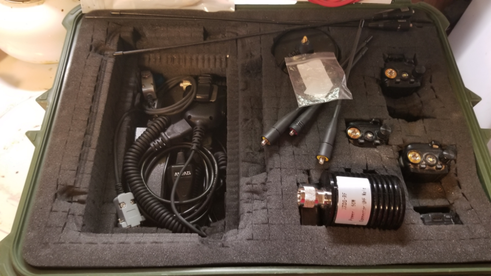

I have a couple of the Apache cases too.  Have a small one for a bunch of radios and accessories and then a larger one for radios and a mobile repeater and antenna plus a bunch of accessories for testing and maintenance.
