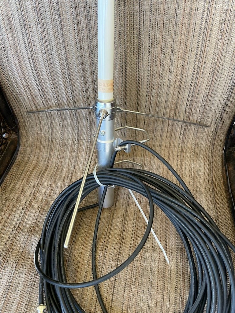

You want your antenna to match the frequencies you're transmitting on as closely as possible. 154/430Mhz is the common VHF/UHF split for a dual band HAM antenna. It won't have good SWR on GMRS since it isn't tuned for the 462/467 range needed for GMRS. It may work, but it won't work well. You want to look for a GMRS specific antenna like this one:

How close to 462/467 must an antenna be to function? I have access to the antenna shown nearby. A friend ran into it and says, "Worthless label. 154/430Mhz. Made in China. About 6 feet tall. 58 cable with a BNC connector. Free to a good home." I'd use it (if it can work with GMRS) on a 15-20' mast with a DB25-G (25W) in a flat, wooded area. I'm not talking 5 x 9 perfection, just adequate to be heard and understood over a short distance, say < three miles. I know, I know, "Try it and find out." I hesitate to try it because 1) it might not work for GMRS and 2) as an apparent dual-band it might lure me into becoming a ham. What say the crowd?
