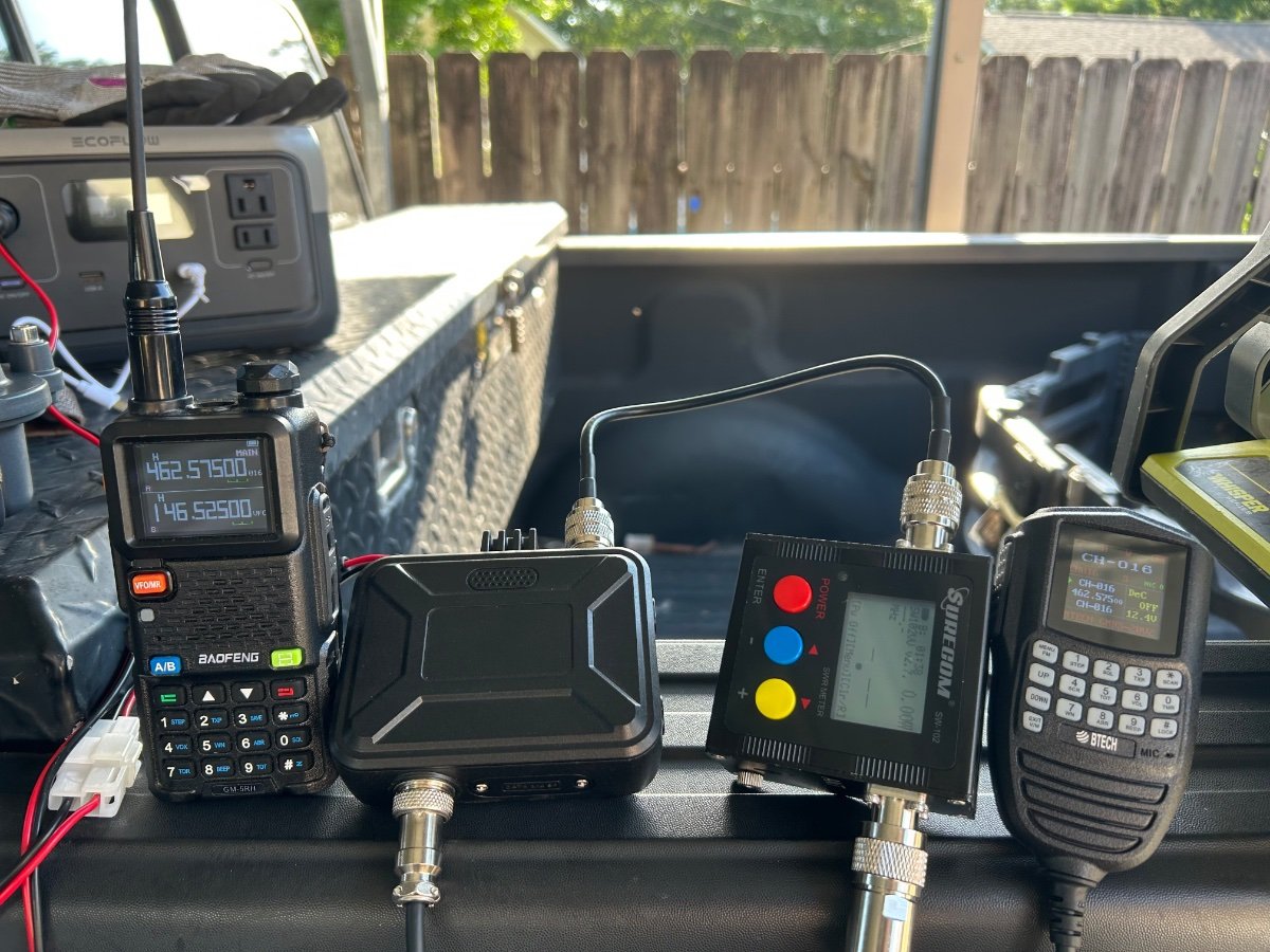

The radio does have a thermal-shutdown.. so if gets too hot for any reason, it will throttle-back and then stop transmitting all-together.. Wait for it to get cold tonight and then try it again.. if still no joy, send it back to the guy you got it from and tell him to send you one that works.
I banned his ars
<Sigh> it wasn’t even turned on. It was plugged into the cig lighter though. Noticed this last week when the truck was outside in the sun too. Thought it might be ambient heat that it couldn’t dissipate (but it wa off then too). Would you expect it to still transmit?

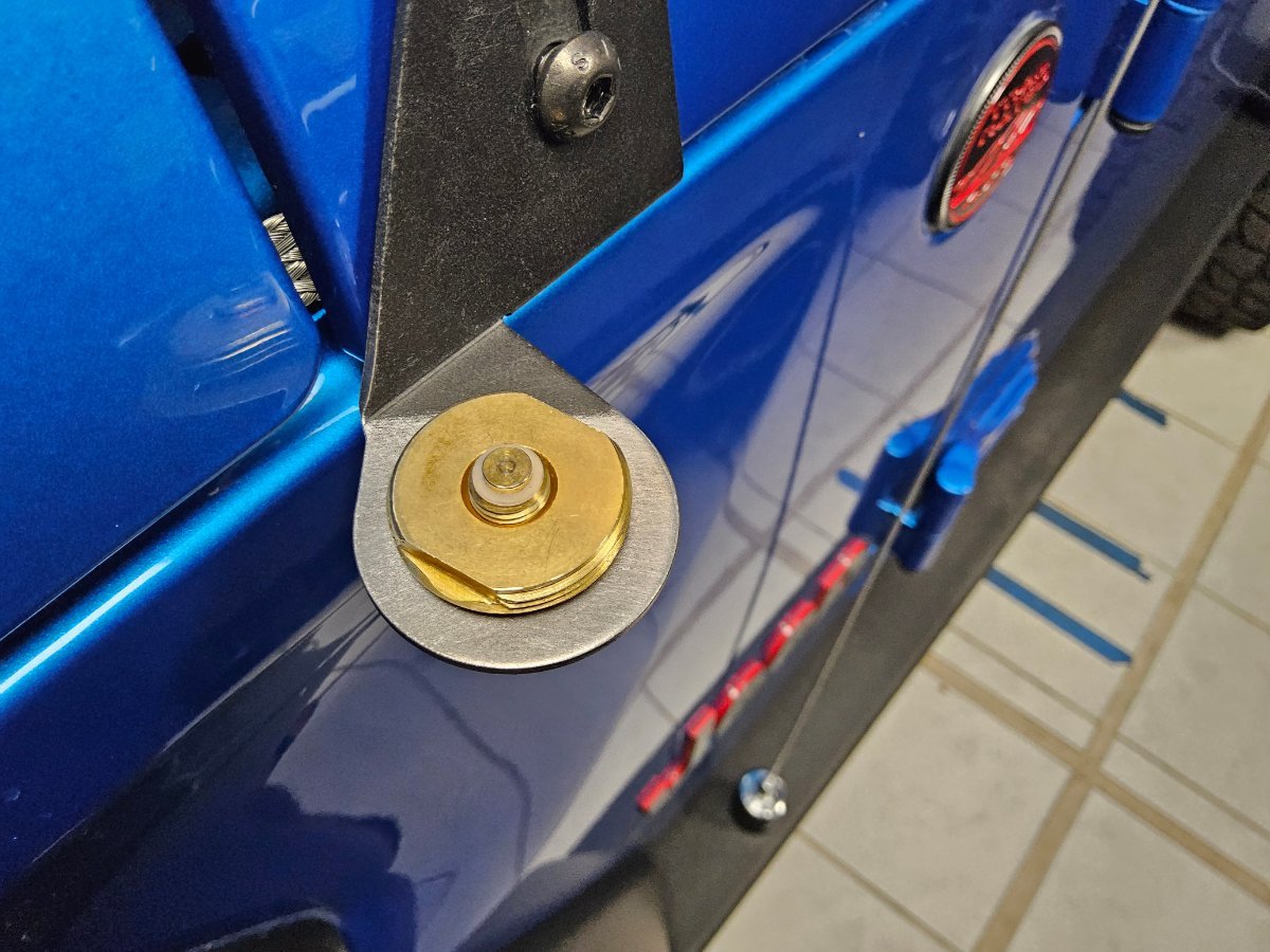

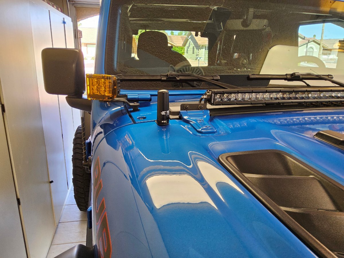

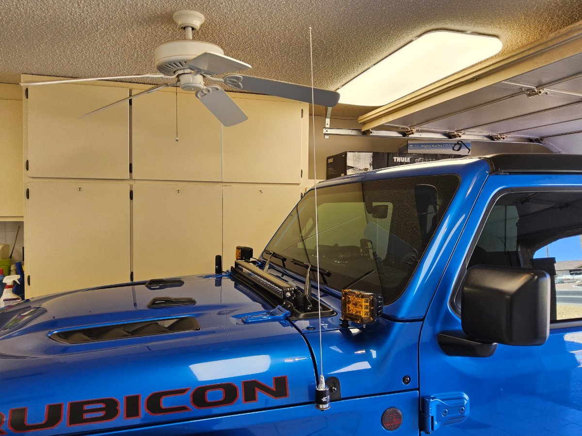

You will need to use two antennae, one for the 70cm freqs and one for GMRS. You should mount each antenna on the side of each cowl nead the "A" Pillar using the Rugged Radios mounting brackets and NMO mounts. Don't use thd cheap stuff get the Laird Mount and Cable from a reputable Radio Electronics Dealer. As for the GMRS antenna since it appears you are only concerned with GMRS for the trail, you should get thd Midland MXTA25 or the MXTA26. Attached is a picture of my Highband VHF antenna on the side near the cowl and "A" Pillar. Also attached is a Laird Lip Mount NMO mount I use for my UHF DMR freqs. The Phantom antenna is a Laird. Just make sure that the mounts have chassis ground continuity without the coax cable connected to the radio.

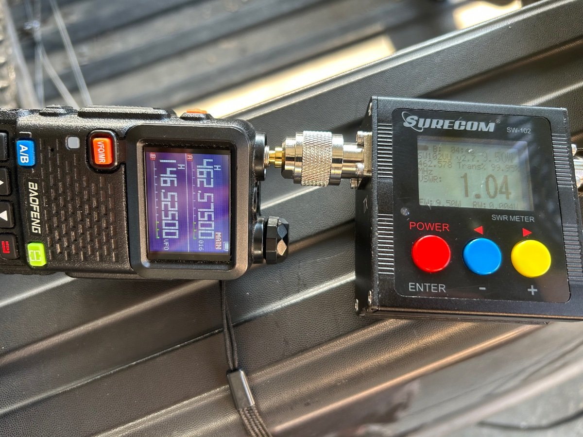

I would say that the radio took a dump. The radio should not be 200 degrees unless you kept it keyed for an extremely long time.
New radio, new questions. I’ve set up a new BTech radio in my truck to use as mobile comm. Today I wanted to see what kind of output I would get on a larger base antenna. I connected it to the Surcomm with the appropriate adapter. At first, I tried it on channel 16 and it was registering close to 19 W. Then I went to channel 23 to see how frequency would affect output. It briefly showed the output still approximately 19W. But then it went blank. There was no reading. When I went back to 16, no measurements. I then hooked the meter to an HT that I had and it seemed to work fine. Went back to the mobile and I could not get the meter to read the output or SWR from the mobile unit. I do want to say that the BTech was extremely hot (Close to 200°F) but I did check it with the truck running, with the truck off and with radio connected to a power bank with no readings. I changed the adapter cord as well. I took the mobile unit out, put a fan on it to try and cool it to see if that made a difference and it did not. I am able to communicate with an HT on channel 16, so I know it is outputting something, but it does not read on the meter. Any thoughts on if it’s the meter, the radio, or something else?
