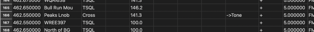

  9. And i just noticed in my example file pulling up my code plug for my mobile radio, for memory 166, I misspelled Knob as Lnob. Great, I need to buy a laptop. Its a pain to pull my mobile out and bring it in to reprogram from my desktop... I could do it by hand, but im too old and need readers glasses, F that

  13. It seems more confusing than it is.... you will get it, we all had to get it.. Location 166 is what it should look like. Hit the options for tone mode, set to cross, it asks for the Mode, use the ->tone, then when you select that it needs the tone. Go left to right with the settings.

  17. Although for instance, if the local area had say, lots of interference or simplex on 462.65, tuning out the stuff as best as you can with the output tone in is a good idea if you just want repeater traffic. So to set it exact, Tone Mode should be cross, Tone Squelch should be 136.5, Cross Mode should be ->Tone, duplex +, and Offset 5.000000

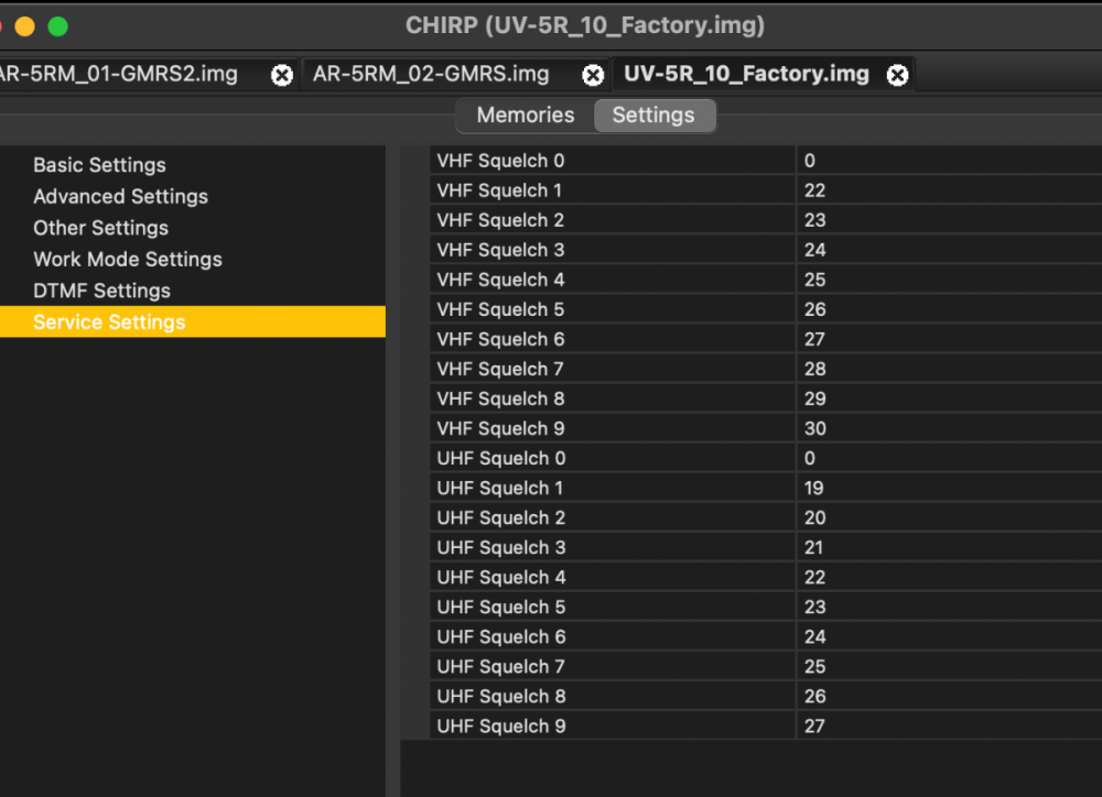

  18. One of the things that was an issue with the UV-5R, and this probably is not new info but might have a reason they do not pick up as well, was the factory squelch settings were terrible. So might be a Duh! we knew that, but I toss it out as well. I set mine and they work well for me with a spread up to around 60, with level 1 being one. I can run mine on that setting 90 percent of the time with good reception and no problems.
