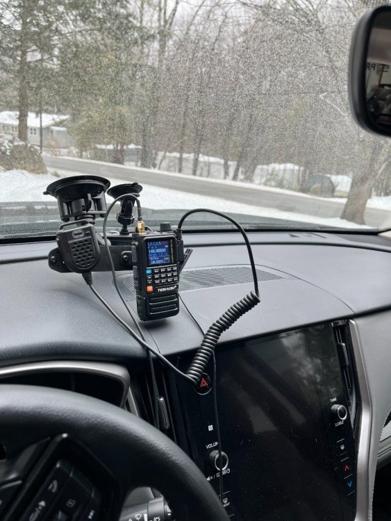

Tram 1711 on my Outback. SWR is 1.02 in the middle of the VHF band, no higher than 1.22 at either edge. A bit higher (1.3-1.4) in the UHV range but still acceptable. Rx and Tx range is acceptable considering vertical location and length of antenna (40-50 miles with 5-9 signal reports at 40w VHF and 25W UHF.

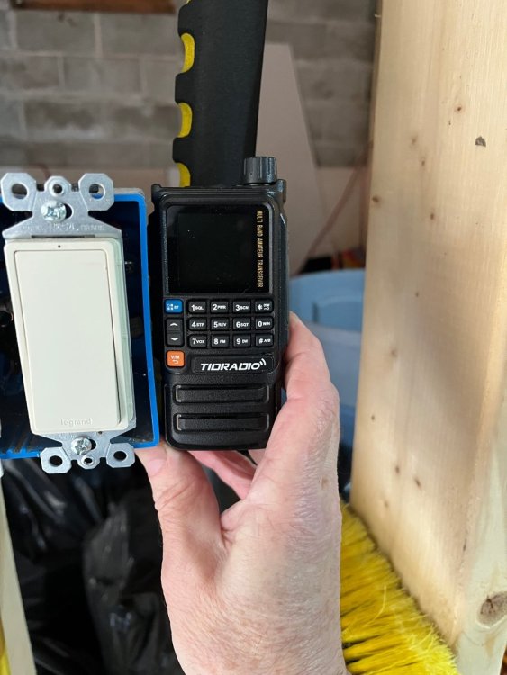

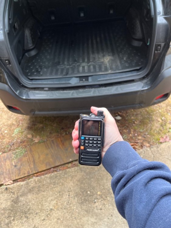

That photo is inaccurate, that or the hand belongs to an 8yo. I am a small person (5'2", 135lbs). It is definitely not that big. In the pic it looks bigger than a UV5R (I have two of those) and this is significantly smaller than that. Here is mine, hopefully this gives a decent size reference. The speaker mic is a mini, just a fraction over 1" wide. I'll take a pic with it in my hand (or with something that will give good size reference) tomorrow if that helps.
