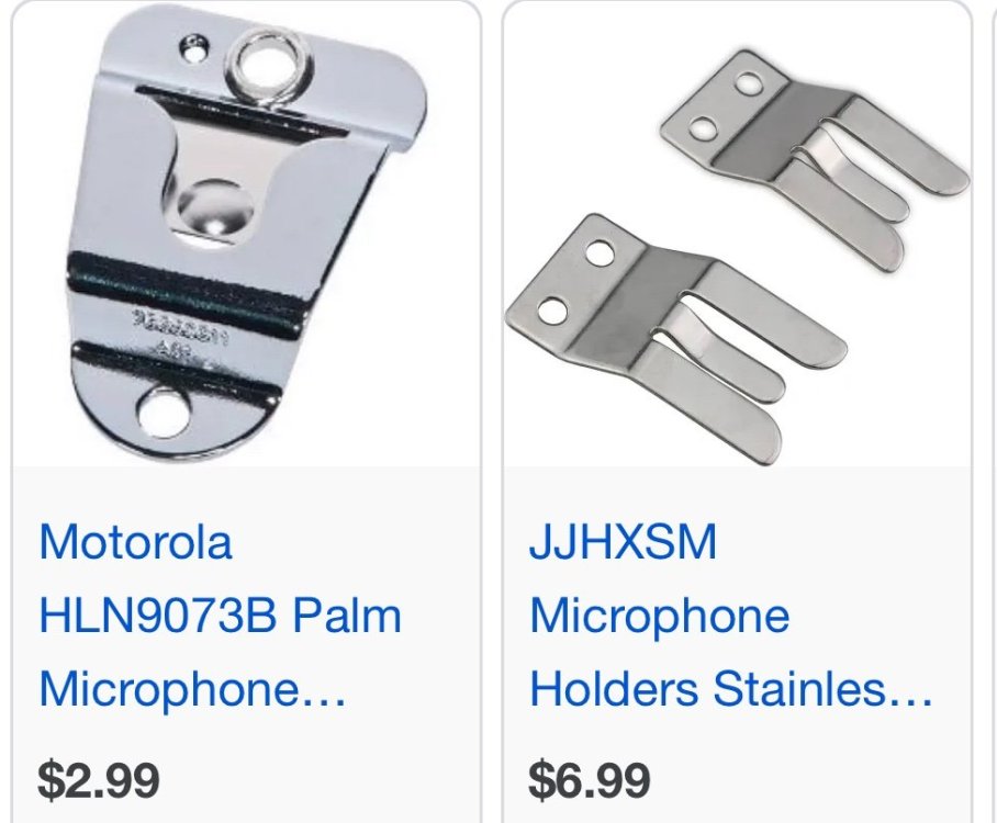

Of course this had to be a Wouxun issue.
This is how I solve this issue.   $3 and solves the problem and the mic will never come out no matter how rugged the ride is.   Same solution has been around for 50years.   No need to make gimmicky stuff that has to be modified out of the box
No doubt, the HLN9073 is the more elegant of the two designs.  JJHXSM-like mic holders came with my Wouxuns mobiles. They are a little bendy, but useable.  However, to use one in my particular car, it would require me to screw it to the dash or center console and suffer an awkward reach or create interference with other stuff. None of which are acceptable to me. The magnet solution, while imperfect, allows me to secure the mic to the radio's mounting bracket without effort or precision.

Of coarse this had to be a woxoun issue.
this is how I solve this issue.   $3 and solves the problem and the mic will never come out no matter how rugged the ride is.   Same solution has been around for 50years   No need to make gimmicky stuff that has to be modified out of the box
