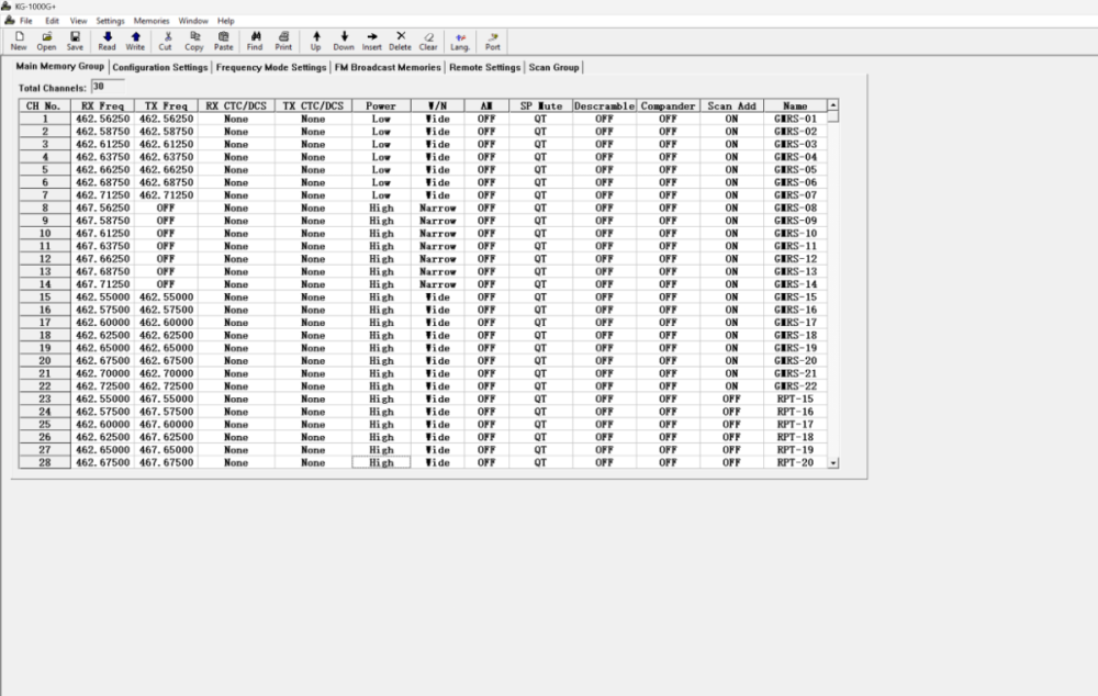

Does anyone know what the frequency setting for 18-10 on a GMR2-PLUS are? and how to get them on a KG-1000G?

I have been running the KG-1000G for 4 years now and do not want to switch away from it. So I figured I would poke around and see if I could find the setting for 18-10.
Using this post, I have programmed the same 18-10. So my settings end up looking like this
Location,Name,Frequency,Duplex,Offset,Tone,rToneFreq,cToneFreq,DtcsCode,DtcsPolarity,RxDtcsCode,CrossMode,Mode,TStep,Skip,Power,Comment,URCALL,RPT1CALL,RPT2CALL,DVCODE
1,GMRS-01,462.562500,,0.000000,,88.5,88.5,023,NN,023,Tone->Tone,FM,5.00,,1.0W,,,,,
2,GMRS-02,462.587500,,0.000000,,88.5,88.5,023,NN,023,Tone->Tone,FM,5.00,,1.0W,,,,,
3,GMRS-03,462.612500,,0.000000,,88.5,88.5,023,NN,023,Tone->Tone,FM,5.00,,1.0W,,,,,
4,GMRS-04,462.637500,,0.000000,,88.5,88.5,023,NN,023,Tone->Tone,FM,5.00,,1.0W,,,,,
5,GMRS-05,462.662500,,0.000000,,88.5,88.5,023,NN,023,Tone->Tone,FM,5.00,,1.0W,,,,,
6,GMRS-06,462.687500,,0.000000,,88.5,88.5,023,NN,023,Tone->Tone,FM,5.00,,1.0W,,,,,
7,GMRS-07,462.712500,,0.000000,,88.5,88.5,023,NN,023,Tone->Tone,FM,5.00,,1.0W,,,,,
8,GMRS-08,467.562500,off,0.000000,,88.5,88.5,023,NN,023,Tone->Tone,NFM,5.00,,1.0W,,,,,
9,GMRS-09,467.587500,off,0.000000,,88.5,88.5,023,NN,023,Tone->Tone,NFM,5.00,,1.0W,,,,,
10,GMRS-10,467.612500,off,0.000000,,88.5,88.5,023,NN,023,Tone->Tone,NFM,5.00,,1.0W,,,,,
11,GMRS-11,467.637500,off,0.000000,,88.5,88.5,023,NN,023,Tone->Tone,NFM,5.00,,1.0W,,,,,
12,GMRS-12,467.662500,off,0.000000,,88.5,88.5,023,NN,023,Tone->Tone,NFM,5.00,,1.0W,,,,,
13,GMRS-13,467.687500,off,0.000000,,88.5,88.5,023,NN,023,Tone->Tone,NFM,5.00,,1.0W,,,,,
14,GMRS-14,467.712500,off,0.000000,,88.5,88.5,023,NN,023,Tone->Tone,NFM,5.00,,1.0W,,,,,
15,GMRS-15,462.550000,,0.000000,,88.5,88.5,023,NN,023,Tone->Tone,FM,5.00,,50W,,,,,
16,GMRS-16,462.575000,,0.000000,,88.5,88.5,023,NN,023,Tone->Tone,FM,5.00,,50W,,,,,
17,GMRS-17,462.600000,,0.000000,,88.5,88.5,023,NN,023,Tone->Tone,FM,5.00,,50W,,,,,
18,GMRS-18,462.625000,,0.000000,,88.5,88.5,023,NN,023,Tone->Tone,FM,5.00,,50W,,,,,
19,GMRS-19,462.650000,,0.000000,,88.5,88.5,023,NN,023,Tone->Tone,FM,5.00,,50W,,,,,
20,GMRS-20,462.675000,,0.000000,,88.5,88.5,023,NN,023,Tone->Tone,FM,5.00,,50W,,,,,
21,GMRS-21,462.700000,,0.000000,,88.5,88.5,023,NN,023,Tone->Tone,FM,5.00,,50W,,,,,
22,GMRS-22,462.725000,,0.000000,,88.5,88.5,023,NN,023,Tone->Tone,FM,5.00,,50W,,,,,
23,RPT-15,462.550000,+,5.000000,,88.5,88.5,023,NN,023,Tone->Tone,FM,5.00,S,50W,,,,,
24,RPT-16,462.575000,+,5.000000,,88.5,88.5,023,NN,023,Tone->Tone,FM,5.00,S,50W,,,,,
25,RPT-17,462.600000,+,5.000000,,88.5,88.5,023,NN,023,Tone->Tone,FM,5.00,S,50W,,,,,
26,RPT-18,462.625000,+,5.000000,,88.5,88.5,023,NN,023,Tone->Tone,FM,5.00,S,50W,,,,,
27,RPT-19,462.650000,+,5.000000,,88.5,88.5,023,NN,023,Tone->Tone,FM,5.00,S,50W,,,,,
28,RPT-20,462.675000,+,5.000000,,88.5,88.5,023,NN,023,Tone->Tone,FM,5.00,S,50W,,,,,
29,RPT-21,462.700000,+,5.000000,,88.5,88.5,023,NN,023,Tone->Tone,FM,5.00,S,50W,,,,,
30,RPT-22,462.725000,+,5.000000,,88.5,88.5,023,NN,023,Tone->Tone,FM,5.00,S,50W,,,,,
32,18-10,462.625000,,0.000000,TSQL,94.8,94.8,023,NN,023,Tone->Tone,FM,5.00,S,50W,,,,,
I am able to hear the traffic on this channel but I am not able to transmit myself.
If I press the transmit key, the radio will beep at me and nothing is transmitted.
Any help would greatly be appreciated.
