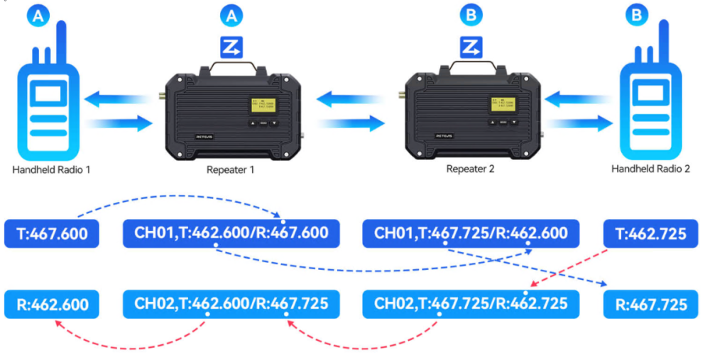

0 tweiss3 Posted August 14, 2025 Posted August 14, 2025 Interesting concept. Not exactly sure how it's accomplished with a single duplexer though, unless both sides (462&467) are full RXTX units. Either way, talk about long squelch tails and lag. Quote
0 LeoG Posted August 14, 2025 Posted August 14, 2025 467t/462r > 467r/462t > 462r/467t > 467r/462t So one radio needs to be in talk around mode. You would need a 3rd repeater to make it normal. Quote
0 SteveShannon Posted August 14, 2025 Posted August 14, 2025 Just now, LeoG said: 467t/462r > 467r/462t > 462r/467t > 467r/462t So one radio needs to be in talk around mode. You would need a 3rd repeater to make it normal. The problem is that it results in an infinite loop, going right back to the first repeater. Quote

0 mb523 Posted August 14, 2025 Posted August 14, 2025 Here is the image they provide on the product page showing the channel pairs used. They basically suggest using both the 600 and 725 repeater pairs as a means of setting this up, repeating to and from 600 and 725. SteveShannon, DeuceoneRadio and WRUU653 3 Quote
0 SteveShannon Posted August 14, 2025 Posted August 14, 2025 45 minutes ago, mb523 said: Here is the image they provide on the product page showing the channel pairs used. They basically suggest using both the 600 and 725 repeater pairs as a means of setting this up, repeating to and from 600 and 725. Thanks, that’s very helpful. So each repeater is capable of receiving on two different frequencies and repeating on one. Interesting. I learned something new today. I’d like to hear from someone who actually has tried it. WRUU653 1 Quote

0 WRTC928 Posted August 15, 2025 Posted August 15, 2025 3 hours ago, OffRoaderX said: Me too... I HAD two brand new RT97L's that I could have used to test this.. but I gave them both away.. Now i'm kicking myself and I wish I was not so kind, unselfish and loving toward my fellow-man... Never again! I doubt you could do it with two off-the-shelf RT97Ls since they can only listen on one frequency at a time. If I understand the setup, each one has to monitor two frequencies simultaneously. It's a pretty cool setup, though. Quote
