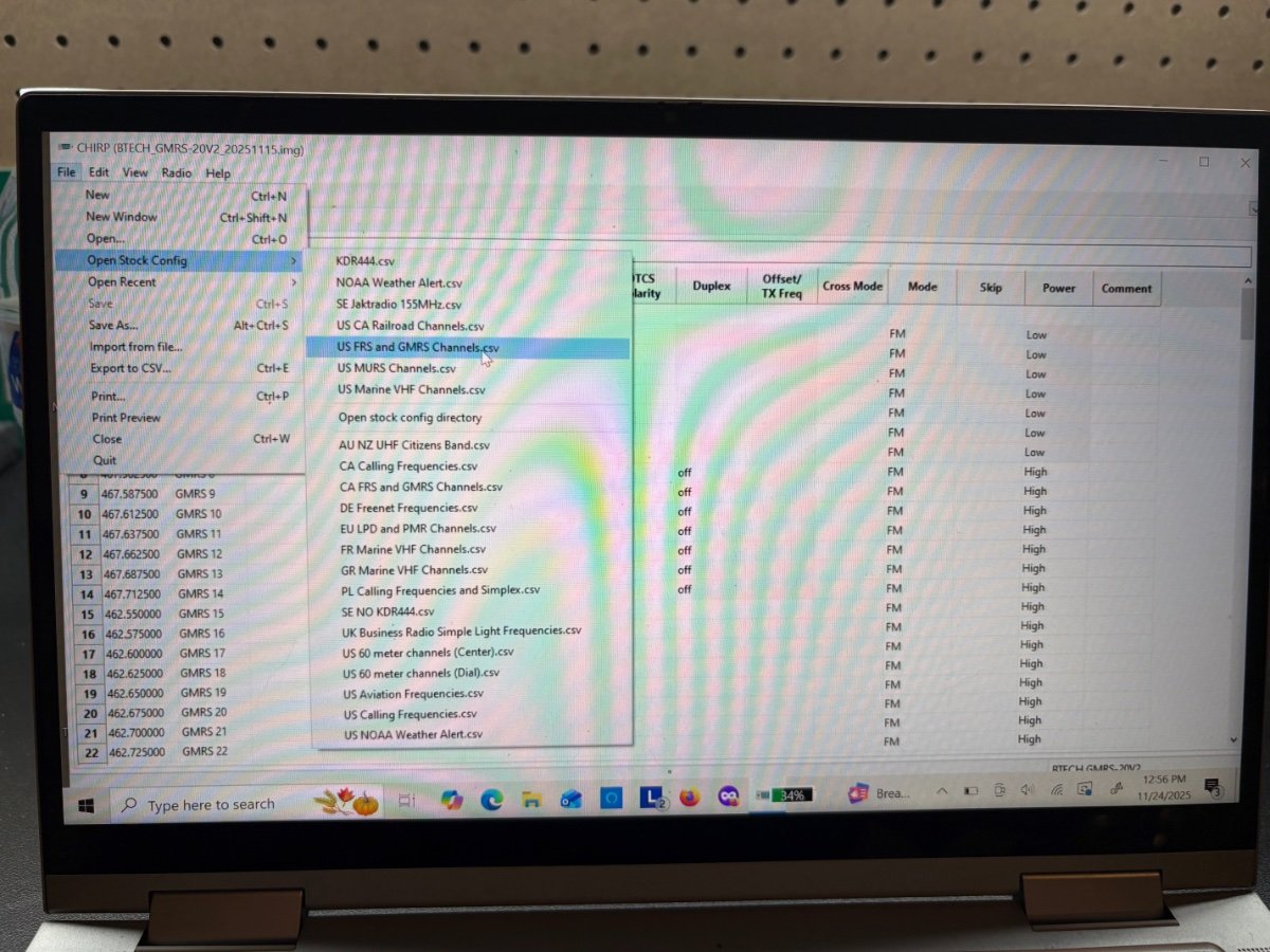

How would we go about testing radio to radio without interfering with our local repeater? Again, my apologies for being so naive on this, really trying to learn here. We are mainly using Tidradio h3 plus's and a mixbag of Baofengs UV5s. Thank you!
Channels 1-14 will not interfere with local repeaters.  Channels 15-22 transmit and receive on the same frequencies the repeaters transmit on.  Repeaters receive on higher frequencies.
So, just stay on 1-7 (if you want to use five watts) or 8-14 if you want to keep your power very low. Your radios should automatically adjust the power output.

Once you have your radio connected to chirp and in the radio tab down load from. Just go to file - open stock config-US frs and GMRS. Then load it to your radio. Repeat upload on every matching radio  may need to move the list down one spot if the radio starts with 0 instead of 1  the easiest way is to copy and paste the the list to your original downloaded file/channel list

how would I program our radios to transmit on channels 1-7? Right now, channels 1-7 on my radio are local stations for county fire, EMS and police. I programmed all of our radios on Chirp.
I mean...
Pretty much the same way you did this....but with the correct frequencies for GMRS / FRS 1-7.
Which, if you're using Chirp, you don't even need to look up. They are there in the tool.

Chirp has the ability to populate the entire range of GMRS frequencies in the correct order.

thank you everyone for your help!! I went on chirp and reprogrammed my radios using the FRS channels above. I set a random tone for the channel and tested it out on low power over a few acres and it worked beautifully. learned something new from everyone! I love this new to me hobby!
