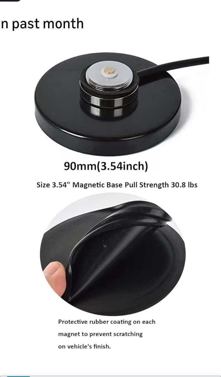

I was wondering the same thing about the rubber caps on my Radioddity triple mag-mount.  So the metal of the vehicle will still operate to improve the "radials' of my antenna when mounted on my car even with these rubber caps?
I use Midland or Melowave NMO mag mounts. They have a good rubber cover on them. I still clean under the mount and the rubber cover on a regular basis.

I have the MXTA26 and it has the little rubber cup that goes on the magnet.  Even if it did collect dirt and rub the paint off no one is going to see it anyway.  Plus my truck isn't as old as yours but at 18 years I think about it like you do.

just buy the midland nmo mag mount it comes with a very robust rubber cup around the magnet so it won't scratch anything.

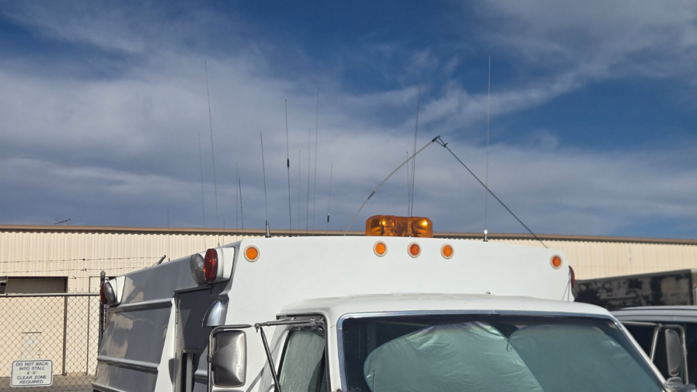

HA!!  I always liked this one.  This is what your vehicle might look like when you stop worrying about the paint, and scratches, and holes...
Seriously:  Good luck with your mag mount. I too struggled for a solution so as to not damage my vehicle.
Looks like an incident command vehicle I saw this summer haha
