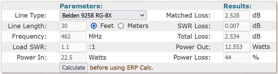

LeoG Posted January 30 Posted January 30 Here's the info for the cable at GMRS frequencies just to show you how much you can lose if you aren't matching your cables to the frequencies you are using. Even good cable is kinda lossy. In order to get lower loss you need to get into the hardlines. Quote
WSKY567 Posted January 31 Author Posted January 31 2 hours ago, LeoG said: Here's the info for the cable at GMRS frequencies just to show you how much you can lose if you aren't matching your cables to the frequencies you are using. Even good cable is kinda lossy. In order to get lower loss you need to get into the hardlines. That's really handy. Would you share where I might find that calculator so I can compare LMR-400 to 1/2" Helix? Calculations look to be accurate as log 3db is a half power ratio. Quote
LeoG Posted January 31 Posted January 31 Here ya go. https://kv5r.com/ham-radio/coax-loss-calculator/ WSKY567 1 Quote
