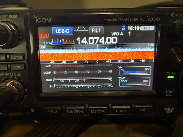

WRYZ926 Posted February 4 Posted February 4 Now here is a high noise floor! That was on January 3 2026. I had a high noise floor on every band but 20 was the worse. WSHL413 and TNFrank 2 Quote
