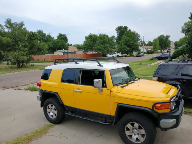

WRHS218 Posted July 17, 2021 Report Posted July 17, 2021 Hasaf, I have a 2m mounted in my FJ. I took the head liner down enough to use marine epoxy to a attach a piece of hardwood 2x4 to the roof and install an NMO. I put the headliner back up and mounted the radio mount to the 2x4. The radio has been mounted that way for 9 years of pretty heavy off road use. I never thought about under the passenger seat. Which brings up another point: It is disturbing how clean it is under your seats! Sean Quote

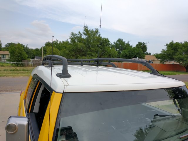

Hasaf Posted July 18, 2021 Author Report Posted July 18, 2021 Here are the antennas. GMRS in the centre rear, VHF/UHF in the centre front, CB (11M) in the left rear by the hinges. gortex2 1 Quote

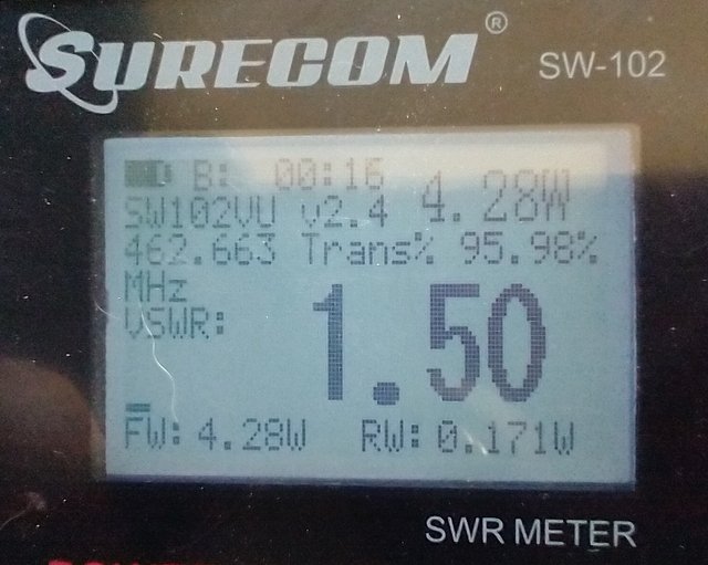

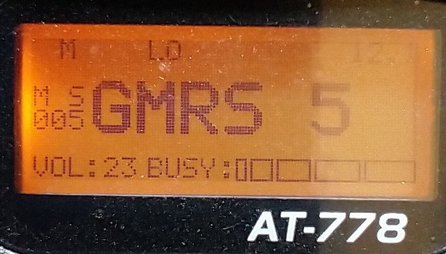

Hasaf Posted July 24, 2021 Author Report Posted July 24, 2021 Sorry it has taken me so long to finish this. The frequencies were programmed from this chart. I have not confirmed the Frequency counter. However, I have not adjusted it either. If it is to be trusted, this radio is transmitting a bit off frequency on Channel 20. The Channel 5&12 frequencies may be a rounding error. According to the manual, both the receiver and the transmitter are capable of both narrow and wide band. However, I do not have the means of testing this. More troublesome is the low power output. The specifications claim 25W at full power. the test showed 17.77W. At low power the specifications claim 5W and the meter showed 4.28W. Ignore the SWR, I am using a Midland MXTA26 and it is ~1:1 on channel 12, but falls off, pretty quickly, on both sides. On Channel 20 On Channel 5 Quote
tweiss3 Posted July 27, 2021 Report Posted July 27, 2021 What you have to remember, the published power is really a target power in the programming, and there is almost always a curve or linear relationship to actual power output across the frequencies covered. Usually, the power is within 10% of the published number. The transmitter report showed 42W output for the "full power" version, assuming full power is 45W, that means it was 93% of the published output. This was at 400MHz, and could be better/worse along the UHF band. Take your 5W target and you get 4.65, then take 95% of that for SWR loss and you get 4.4W, not too far off of the meter 4.3W output. Do the same for your CH20, 93% of 25W is 23.25W, then take 89% of that gives you 20W output, close to your meter output. Could there be a minor calibration that is off, or the meter is 10% off? Sure. What I would take away from it is what is your "normal" and see when things change. Quote
gortex2 Posted July 27, 2021 Report Posted July 27, 2021 It also shows more reflected power on highpower. at that point the meter reading is not as accurate. If this is in a dummy load then its bad. If its in the antenna I'd find a dummy load. A $100 meter will be around 10% as said above and looks accurate Quote
Hasaf Posted July 29, 2021 Author Report Posted July 29, 2021 On 7/27/2021 at 10:27 AM, kb2ztx said: It also shows more reflected power on highpower. at that point the meter reading is not as accurate. If this is in a dummy load then its bad. If its in the antenna I'd find a dummy load. A $100 meter will be around 10% as said above and looks accurate No, it was an antenna. I wrote to Midland about it and they responded with, what amounted to, "the antenna is working fine." Mostly my post is because this radio didn't seem to be mentioned here, so I was trying to give potential users some idea of what it was and how well it performed. As I understand, Midland is coming out with a full power unit, with the controls on the microphone, soon. I will probably go that route when they do. Quote
