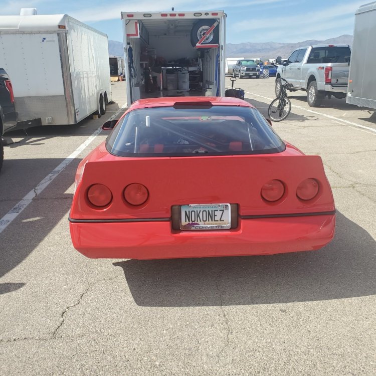

Low Profile. Please note the White Phantom antenna just under the rear window near the top and attached to the rollbar structure. This antenna is a non-ground plane designed antenna.
And these antennae are not "Ghost Antennae", I can clearly see the antenna. They are called Phantom antennae as named originally by Antenna Specialist now called Laird.

Not the one on my racecar. Talley still has  the ANXTRA4500N antenna. Surprisingly, they're still using the Antenex antenna part number.  Unfortunately, the White Phantom is still the only single unit purchase and the Black is a minimum of 10 unit purchase and that is why I have a white Phantom non-ground plane NMO antenna instrad of the black non-ground plane NMO antenna.
