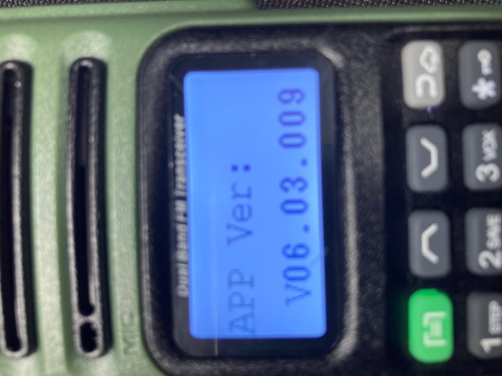

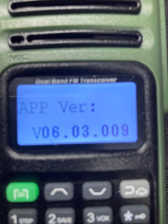

WRDJ205 Posted April 10, 2024 Report Posted April 10, 2024 21 hours ago, TRRP said: So my advise it to get the Radioddity GM-30 software for windows, read the GM-15 pro with it I just programmed my GM-15 Pros today. I had the Baofeng usb cord. I downloaded the GM-30 software from the Radiooddity website. Using a win11 laptop I did not have any issues. I did check the firmware and saw that it was a later version than they had in the example at Radiooddity. My only complaint is that I couldn’t find the option to keep it in single display mode but that was an easy manual fix. With the software I was able to give each of the two radios a name so that I know which use which. Quote
WRXB215 Posted April 10, 2024 Report Posted April 10, 2024 @WRDJ205 what firmware version do you have? Quote
WRDJ205 Posted April 10, 2024 Report Posted April 10, 2024 22 minutes ago, WRXB215 said: @WRDJ205 what firmware version do you have? Sorry for the sideways picture… WRXB215 1 Quote

WRXB215 Posted April 11, 2024 Report Posted April 11, 2024 @WRDJ205 How did you get it to display the version? Thanks. Quote
WRDJ205 Posted April 11, 2024 Report Posted April 11, 2024 I believe you hold down the monitor button when you turn it on. It was in the radioodity folder next to the directions to download. Quote
