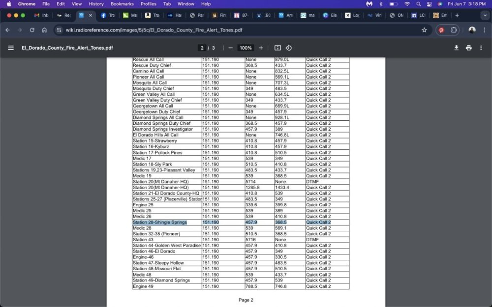

Thank you for the reply and how cool to get a reply from my favorite GMRS YouTuber!!  I enjoy your videos so much and your sense of humor!  Can you let me know what information to put on the line on CHIRP that I have highlighted on the Radio Reference for my fire station?  I have TONE #1, TONE#2, and TONE TYPE, but not sure where those go in CHIRP?

04373651-566D-456F-8468-12890DEDBDCD.thumb.jpeg.e64b0817e6dd10fab3ab3e8898bc5021.jpegotection
CDF provides fire protection for El Dorado County. You listed that you programmed 159.19 Megs and that is an incorrect freq. You need to program 151.19 Megs for the repeater output freq and the mobile decode/Rx PL Tone is 146.2 Hz

That was kinda my guess too especially since the chart he displayed showed the correct freq. 159.190 Megs is not even a FCC allocated freq. Anyways, with all the 151/159 Meg freq pair combos the 159 Meg freq is the repeater input and the 151 Meg freq is the repeater output for CDF/CalFire.
