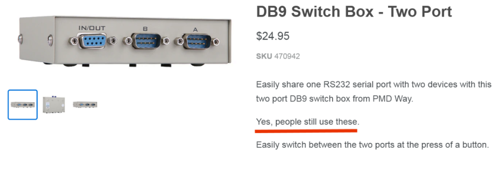

That's one way to do it.  But it has a mic and it'd be nice to still be able to use it.  I'm not always gonna have the radio on me (blaspheme 😱) , the mic is always there.  And yes, I can remove the IDer and plug the mic back in....
There are DB-9 switch boxes that accept two different cables and allow you to select which one to connect. I’ve used them for serial devices (20 years ago!)
7 minutes ago, LeoG said:
Maybe they still exist.  😆
Lots of my radio knowledge comes from that era and before.
They’re certainty still around, but they were designed around serial communications standards, not analog signals.  I don’t know if that’s compatible with the microphone and IDer. I’ll see if I can find a source.  It used to be Black Box.
Edit: I see you found one.
