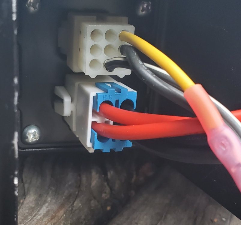

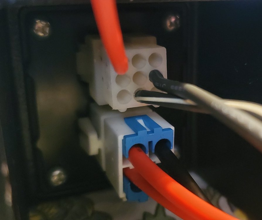

Turns out the ignition sense wire was in the wrong spot in the 9-pin on the back of the radio.  I was told wrong by the seller on ebay (big surprise, right).  He even circled for me, but wrong.  The radio powered up, but I suspect the speaker was getting no power.  Once correct, it all works as it should.  I'm very happy with the radio.
