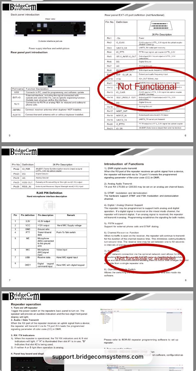

WSEH489 Posted August 31, 2024 Report Posted August 31, 2024 I just received mine the other day and it really solid and weighs about 20lbs. It will be installed once I settle on a site. However from the user manual, it seems there is no remote repeater on/off (kill switch)? Or am I missing something? Dom WSEH489 Quote
WRYZ926 Posted September 1, 2024 Report Posted September 1, 2024 You will have to setup a SYS-OP user and use DTMF tones for remote control. The SYS-OP user is only used for remote control of the repeater. I found the manual somewhat lacking in areas. Here is a good video that helped me out. How to Program the BCR Repeater And another good video: How to Program a BCR Repeater System. This video gives more details about installing the program and getting ports configured. SteveShannon 1 Quote
WSEH489 Posted September 2, 2024 Report Posted September 2, 2024 Thanks however it’s a BDR 50U which from the owner manual, seems to be very different from the BCR line and since the thread title is Bridge-com BDR 50U UHF repeater That’s what caught my attention Maybe their manual is really lacking Quote
WRYZ926 Posted September 2, 2024 Report Posted September 2, 2024 Sorry about that, too much blood in the caffeine system today. 1 hour ago, WSEH489 said: Maybe their manual is really lacking And so are their videos for setting up the BDR50. Setting up the BDR50 for analog use should be the same as the BCR-40. The only decent video I could find for the BDR-50 is this one: DMR MADE EASY! | The Fastest Way to Get on the Air | Step-by-Step Digital Radio Workshop Be warned, that video is an hour long. Quote
BoxCar Posted September 2, 2024 Report Posted September 2, 2024 That Bridgecom video is extremely basic. You need 4 things for a DMR radio, a radio ID, a contact, a frequency, and a zone or grouping of contacts/frequencies. Remember, EACH contact must have a frequency assigned which is not brought in that basic video. WRYZ926 1 Quote
WRYZ926 Posted September 3, 2024 Report Posted September 3, 2024 On 9/1/2024 at 9:07 PM, BoxCar said: That Bridgecom video is extremely basic. Yes it is. I searched for a bit looking for videos on programming the BDR50 but didn't find much. And the manual for the BCR40 isn't all that good either. Quote
