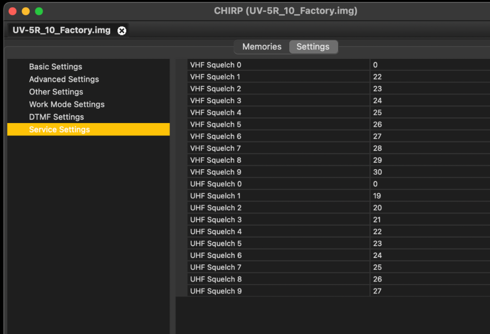

WRXR255 Posted July 7, 2024 Report Posted July 7, 2024 8 hours ago, WRWE456 said: Squelch is not something you program with software. You have to be able to adjust it on the fly as needed, like volume. On the VU-5R Radios you could adjust the squelch setting breaks. It did not have a potentiometer squelch, you set a level of squelch from 0 to 9 in the menu. With that by default, the settings where the break level was in a new radio was kinda bizarre, so any level you had from 1 to 9 was not much different. For instance: You could adjust the levels for each setting from 0 to 120, but in the top pic, I adjusted mine to a max of 60, as above that you were pretty much fully "deaf". WRWE456, SteveShannon and WRXB215 2 1 Quote
Guest Timber_Canyon Posted July 7, 2024 Report Posted July 7, 2024 Thanks for the replies. I think WRXR255 might have gotten it. I should have been more specific, but what I was looking forvwas this. https://www.miklor.com/COM/UV_Squelch.php Quote
