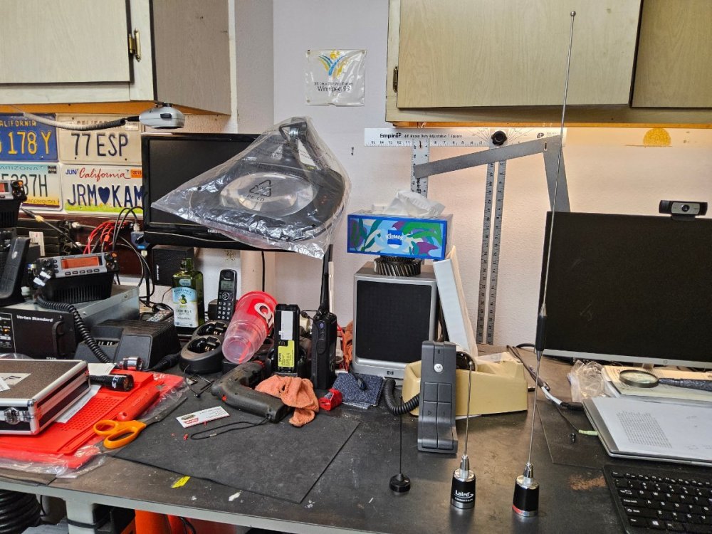

nokones Posted September 12, 2024 Report Posted September 12, 2024 Here are some of the Laird antennae I have available and use. From left to right, I use the Laird 1/4 wave unity gain with my Kenwood TK880-1 on my Porsche up in the hills and mountains during the Porsche Driving Tour runs with great success; the middle antenna is the B4502N non-ground plane 2.4 dB 1/2 wave I use with my Motorola XTL5000 on my 21 Silverado Dually Diesel; and the right antenna is my Laird B4505NS non-ground plane 5/8 wave 5 dB antenna that I never had to use so far. Based on the information posted, you should be ok with the quarter wave unity gain antenna. Try that one first and if you feel you need a little more antenna than the 1/2 wave B4502N that is propery tuned would be the next antenna to try. The 1/4 wave unity gain does not require any tuning. gortex2 and WRYQ303 2 Quote
