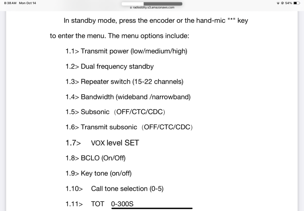

Soggybottomboy Posted October 14, 2024 Posted October 14, 2024 My buddy got this radio and we can't figure out how to make the radio transmit a DCS tone of 315. Our local repeater requires this tone. I understand how to turn on the CCTS but not the DCS. Anyone know? SBB Quote
0 Guest Posted October 14, 2024 Posted October 14, 2024 1 minute ago, Soggybottomboy said: My buddy got this radio and we can't figure out how to make the radio transmit a DCS tone of 315. Our local repeater requires this tone. I understand how to turn on the CCTS but not the DCS. Anyone know? SBB Are you programming on chirp or other computer program? It’s 100,000times easier. Second have you read the directions? It should tell you. Many you tubes also available to walk you through how to do it. Quote
0 SteveShannon Posted October 14, 2024 Posted October 14, 2024 1 hour ago, Soggybottomboy said: My buddy got this radio and we can't figure out how to make the radio transmit a DCS tone of 315. Our local repeater requires this tone. I understand how to turn on the CCTS but not the DCS. Anyone know? SBB You have to choose the SUBSONIC or TRANSMIT SUBSONIC menu and then choose CDC rather than CTC from the menu: WRXB215 1 Quote
0 Soggybottomboy Posted October 14, 2024 Author Posted October 14, 2024 4 hours ago, SteveShannon said: You have to choose the SUBSONIC or TRANSMIT SUBSONIC menu and then choose CDC rather than CTC from the menu: Ok Shannon I'll tell him to give that a try. Thanks very much! The manual was VERY vague. SBB SteveShannon 1 Quote
0 SteveShannon Posted October 14, 2024 Posted October 14, 2024 Just now, Soggybottomboy said: Ok Shannon I'll tell him to give that a try. Thanks very much! The manual was VERY vague. SBB Radioddity says that they have an expanded manual (250 pages) for this radio and two others and they provide a link to the download page, but I can’t find it. Quote
0 Soggybottomboy Posted October 14, 2024 Author Posted October 14, 2024 Interesting. We messed with that thing for 2 hours just to try to make it transmit a DCS tone. Almost at the point of sending it back and choosing another radio. Thanks again. SBB SteveShannon 1 Quote
0 Soggybottomboy Posted October 14, 2024 Author Posted October 14, 2024 He just got it programmed. The manual was no help. I must say, it does sound great into the repeater. Thanks for your help Steve. Jake TrikeRadio and SteveShannon 1 1 Quote
