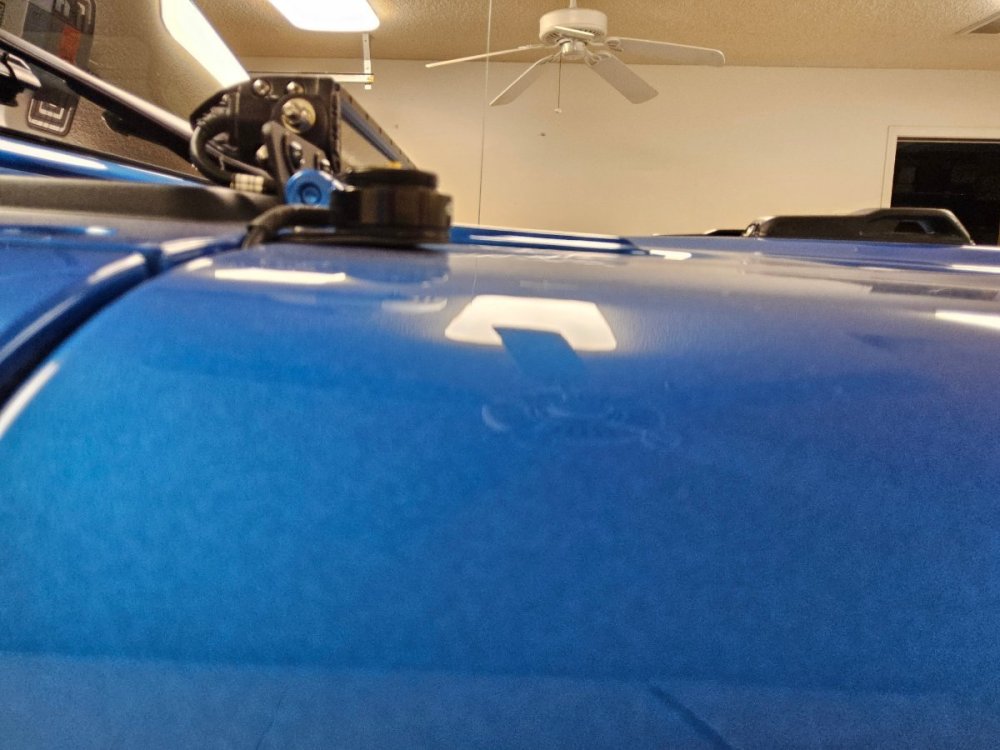

dosw Posted October 22, 2024 Report Posted October 22, 2024 4 hours ago, nokones said: Just bend it to your liking. I had to do the samething on my 23 Wrangler IZARUBI for a Lip-Mount because the curve in the hood which made the antenna point off-to-the-side. Most likely, you will end up with a gap under the mount at some point. With antennas you can't be sure something won't work without testing. Here's an example of my mount that definitely doesn't work... It's never successfully worked a repeater 150 miles away. But it does hit one 65 miles away. Is that good enough? I've tested this setup with five antennas. It checks out on the SWRsometer (both a NanoVNA and a Surecom SW102), and it hits a repeater more than five dozen miles away. Sure, it looks terrible because it's on my beater camping Bronco. But it works very well. Part of what helps it work well is the fact that there is metal in all directions. The Jeep shown metal in all directions too. The slight gap in the metal doesn't make it not work. As for how to keep it from tilting, I had to bend mine a little, and I put a small shim on the inside, where the set screws are, to help it tighten correctly without lifting as much. Here's my install: 19G_vg1sb1V-nOztHafhwNhtVgMN9ggFa 19G_vg1sb1V-nOztHafhwNhtVgMN9ggFa Quote
