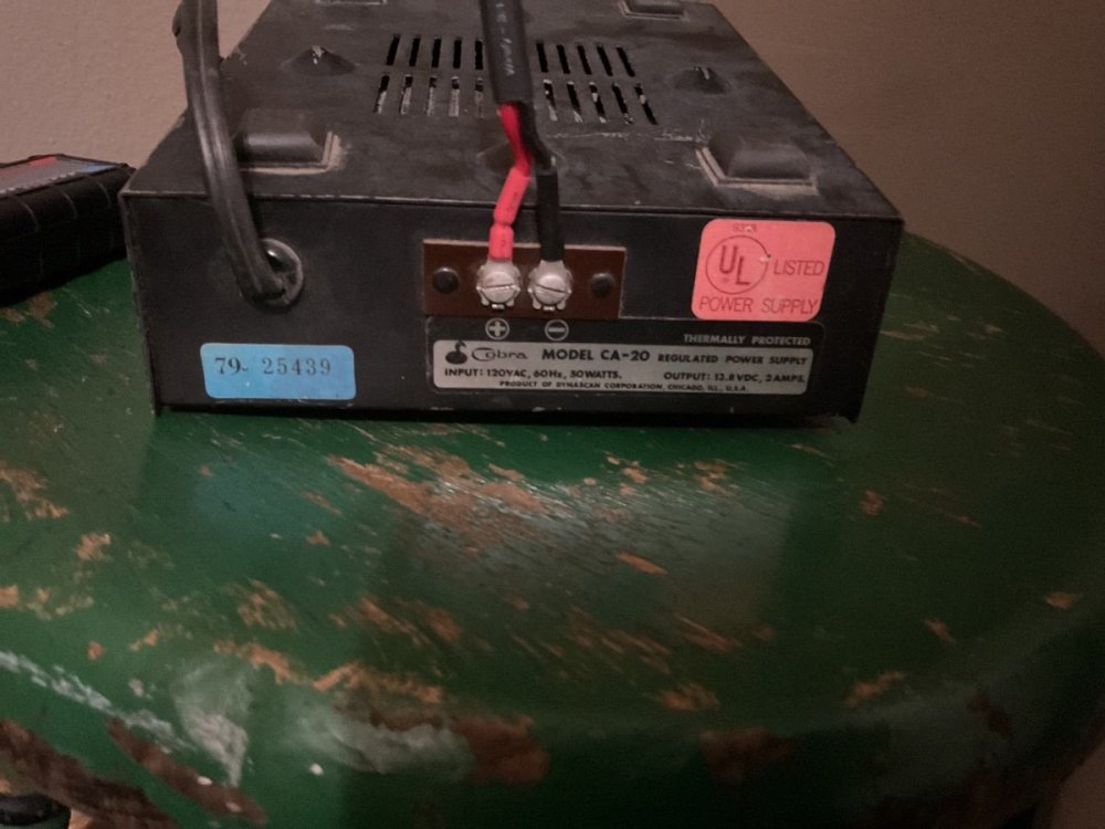

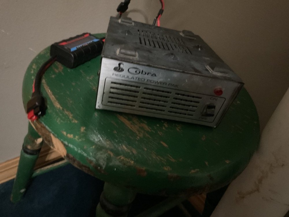

I have tried using a 45 year old Cobra CB linear power supply (pictured below) for my DB20G.  It’s listed at 13.8 volts, but only 3 amps output.  It will run all day long if I stay at medium power output (10 watts) on the radio but it doesn’t have enough continuous current carrying capacity if I switch to high power output (20 watts output).  After a half minute or so the power supply thermal circuit breaker opens up. Then I have to wait for a minute or so for the thermal to reset.
