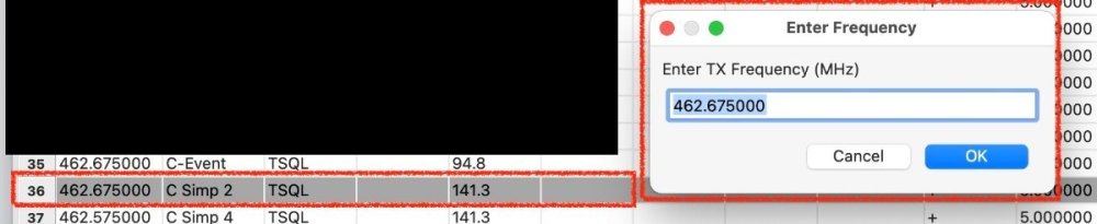

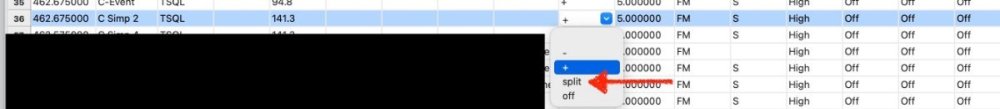

In GMRS MODE... channels 31-54 (I think) will automatically act like they are repeater duplexing channels... where they automatically transmit +5 from the receive frequency. Now, you can override that in chirp by setting the SPLIT instead of the + and entering the same transmit channel to make it a SIMPLEX.
Here are some screenshots of my CHIRP screens and how i set up a simplex channel in channel slot 36 for instance:
first one... shows how I am changing the + to SPLIT... (will be entering the same transmit frq as the receive freq to kindof bypass the repeater offset)
Second image you get a popup to enter the tranmit freq.. make it the sameas you receive.
thrid.. is is set... upload to radio.
note that if you SAVE your chirp files... if you re upload them again at some point wihtout touching the settings for those simplexx channals it might still show it when you reopen the file like it has reset to the + and offset but it will be ok when you put it back in your radio... IF HOWEVER you do make any edits to that line... you WILL have to redo this procecdure or it will think you want it to just do a repeater offset.
hope that makes it clearer and it helps you get it working.

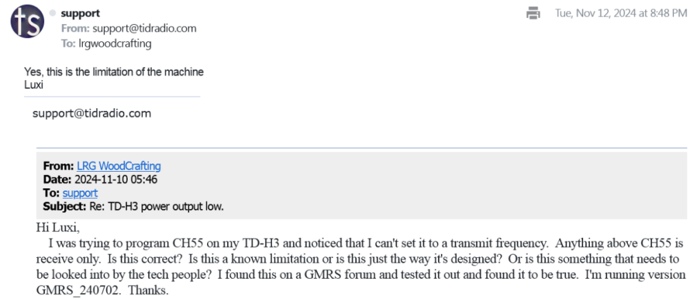

I think the H3 has a limitation that you can only transmit on the 1st 54 programmable channels.  After 54 they are receive only.
@LeoG, that might have been the issue. I may have overlooked it in the owner’s manual about the transmit channel slot limitation. I will have to find it and confirm. But I was able to program GMRS 1 on slot 43 on the keypad with some CTCSS tones and it appeared to transmit. I’m out on the road and can’t test thoroughly. Thank you for the tip.
I have no issues transmitting on higher channels. 185 for example, no issue. GMRS version unlocked.
  • 1
And using the APP from Tidradio I was also not able to program any transmit frequencies into channel 55, I assume and up even though I didn't try.
I have AM stationed programmed into the radio and the APP won't read those from memory either.  If I write back I lose my AM stations (Airport).
