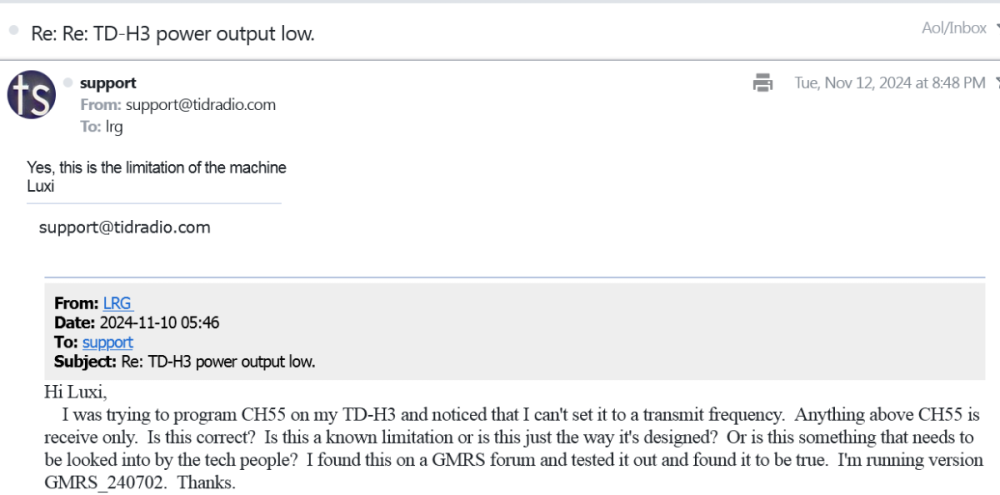

I've already done that and they know of the issue and I doubt they plan on fixing the limitation.
Any problems with those radios are usually solved pretty quickly in all of my cases.  I text Luxi who appears to be the sales front end and tell her my issue.  The only issue that hasn't been solved is the above ch55 issue and I don't think they see it as an issue so I doubt it's going to be resolved.  So if that affects you, don't buy this radio.
