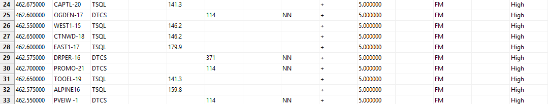

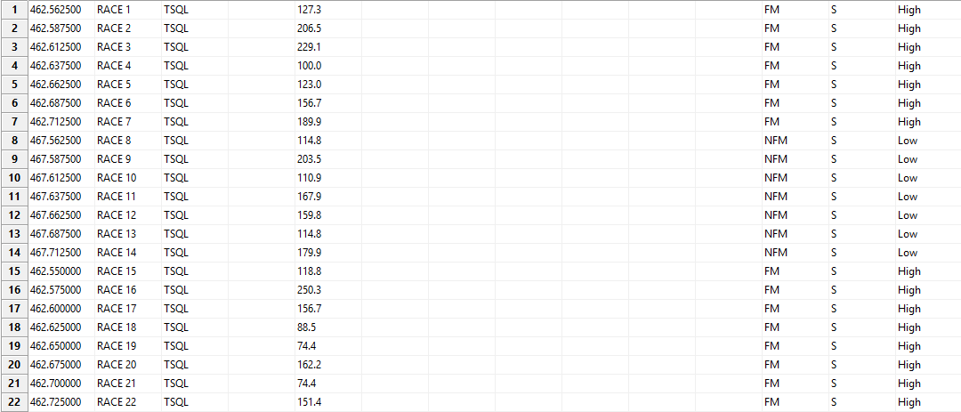

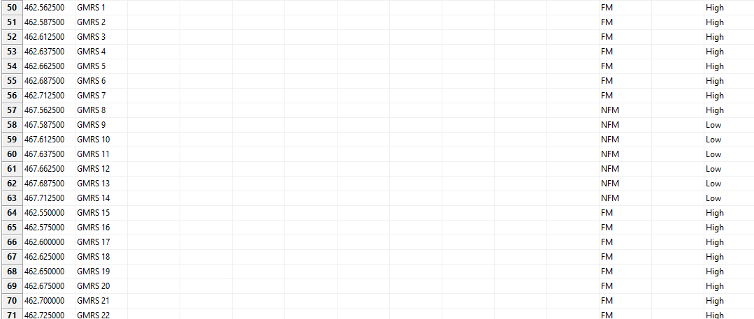

Everyone arranges these things according to how their brain is organized, so you may not do the same thing I would do. If this were me, I'd save this configuration in CHIRP, open a new window, and load GMRS/FRS frequencies from <File> <Open stock config> and copy/paste the frequency list into a clean CHIRP page as a point to start. 23-52 in that chart are the GMRS channels and they already have the bandwidth, power, and tuning step programmed. That gives you a clean place to start. Then open the file with your current configuration and from it copy/paste the channels you want to add. You can do that as a block, for example Fam1 through Caravan, and the four repeaters as another block. I think you'll be happier if you get the GMRS/FRS channels together in order. Then, if you want some channels with "privacy" (they aren't) tones on them, copy/paste a block of frequencies to another set of memory slots and add your tones to them. I used GMRS 15-22 for this because that's plenty for family use and I can use up to 50 watts if I happen to be in a vehicle. Remember to change the names on this block; Fam1, Fam2, whatever. The way my brain works, it's easier for me to remember if I start each block on a number like 50 or 75. This is just a suggestion, though.
With your frequency numbers on the channels being wrong / all over the place, I'm leaning towards starting over being easier, honestly. The nice thing with Chirp is that you can do that pretty easily. 1. Read from your radio so you've got your current config (or open your current config). 2. go to File > Open Stock Config > US FRS and GMRS. 3. Do another Read from Radio from your radio so you can get a 2nd page open with your radios config, and blow the memory channels away on this one so you've got a blank slate. What you're doing makes sense (having a few personalized channels for yourself + the standard GMRS channels) but not when your labeling (FRS1) doesn't actually match up with what frequency FRS1 should be (you have 467.5500, but it should actually be 462.5625...). Otherwise your radios aren't going to work with other people's. I have no idea where you got that frequency list from, but it needs to go in the trash haha Compare yours with the file in #2 above and you'll see what I mean. Also know that unless the person you're trying to talk to isn't transmitting the tone your radio is listening for, you will not hear them. So if someone is on a standard, no tones channel, let's say, GMRS1, and your GMRS1 (or FRS1, they're the same, more or less), assuming you've corrected the frequencies, but you have a tone, you won't hear them. So it's a good idea to have a set of "Open" channels on your radio as well. This is what my normal loadout looks like. The first set are what we use at the track when we're trying to just hear ourselves and not anyone else who might be on an open GMRS channel, the my local repeaters, then a full set of 'open' GMRS channels.

THanks for the feedback. The intent here was to have all available GMRS and FRS channels. To have a few GMRS channels that were set for family communication, and then to be able to touch my local repeaters. With that context, am i close or do i need to restart this whole thing?
