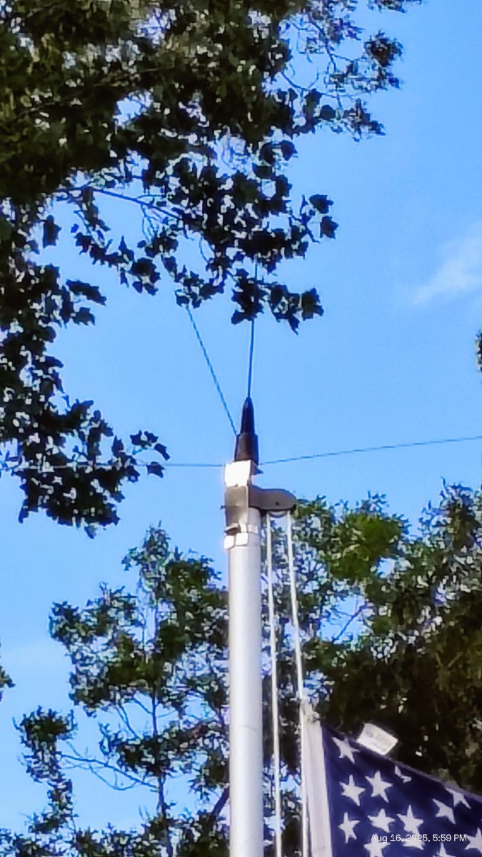

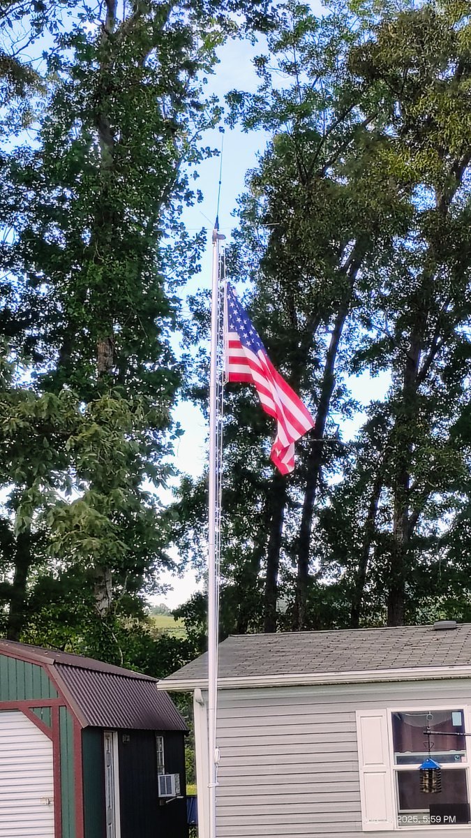

Images of what I have, the Browning LMR-400 cables are a 25' run down the inside of the pole to a lightening arrestor in the ground attached to a 50' to the Radio. Currently, I have the Midland MXTA-26 antenna on it, trying to see if any difference in SWRs, maybe .1-.3 difference.
The aforementioned Tram above which is mounted on my flagpole 25' up

To what do you have the antenna mounted?
Since NOONE is bothering to look, the 2 items are ground plane brackets, that I don't believe I even need, other than to attach a cable at one end and antenna on the other. I asked the question before I wasted anymore money on the Nagoya if the result will be the same, I needed a bracket, similar to the Midland MXTA-23 I believe only without a cable attached to mount the antenna more securely to the top of the 25' flagpole I put it on top of. Having gotten my answer with that, I do still have questions as to why I'm still getting the problem as far as the links, most forums will convert links to photos and since there's so many sad hams here I quit coming here for answers and generally look elsewhere. Not able to find what I was looking for for, I posted in the most logical place to ask my question. Other forums will convert posts to visual of items and even those that don't, most people actually at least click on one to know what they're talking about before even posting comments back. Then sad hams aren't part of those forums either
I knew who he was talking to. I also know that something's awry with the 4.6 SWR readings. I'm running a tuned Laird B4505CN on top of it. Tuned using a Laird G8 base. I expected it to be off, I didn't expect it to be off that much.

I second this. I have the same antenna on a 36' mast for my repeater and I get 10-15 miles depending upon the direction. Terrain is less favorable to the northwest than in the other directions. When I'm recovered from my shoulder surgery, I'm going to put the antenna on a 50' mast. The greatest "bang for the buck" is almost always getting the antenna up higher.

He was responding to me, not you. And he was very helpful. If you're getting an SWR 4.6, something is definitely awry. What kind of antenna are you running on the Tram base?
