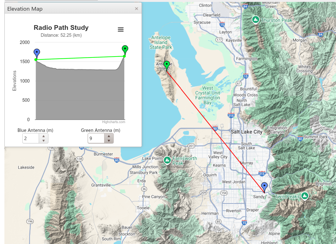

Is there a mountain between you and the further away repeater like with the closer one? I regularly and normally connect to a repeater 69 miles away on my handheld radios and using my base-station with a big antenna on the roof, i can connect to repeaters 80 or 90 miles away - yet there are other repeaters 10 miles away that I cant connect to because of hills/mountains. -

It’s possible that it is tropospheric ducting. It’s also possible that the farther repeater’s signal is getting to you because they have a very high antenna or because it is reflecting off something or refracting over a sharp edge. And it’s also possible that the distant repeater is linked with a nearby repeater. If your radio doesn’t have a receive tone set, it won’t matter what the repeater output tone is; your radio will allow the audio to be reproduced. -

greetings all! new to gmrs radio and had a repeater question. anyone now how its possible for my base station (20w) radio to make contact (receive & transmit) to a repeater that's over 75 miles away? i'm using a amazon special gmrs fiberglass antenna that's only mounted 10 ft off the ground. i have a local repeater approx. 6 miles away that uses .575 frequency with a tone of 162.2 in and out. i can't connect with it due to a mountain in between it and my location. as stated, the other evening i was able to communicate with the repeater that's further away which does have a .575 frequency with a tone of 162.2 in but 198.8 out. i'm not sure how this is possible; am i some how connecting to the repeater local to me and it relaying he signal to the further repeater even though it has a different output tone?
