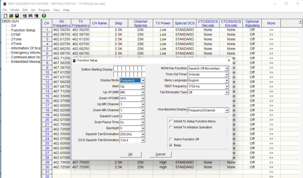

DB20-G Opening message not changing with CPS
WRYS709 replied to WQZV555's question in Technical Discussion

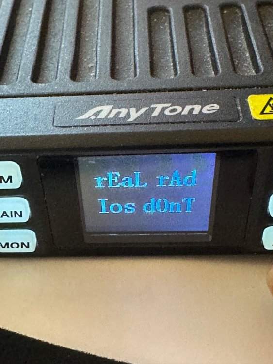

Which Radioddity radios do you own whose software you have never had much luck with? Not sure why you are criticizing the DB20-G's ability to show your call sign on its startup screen: -

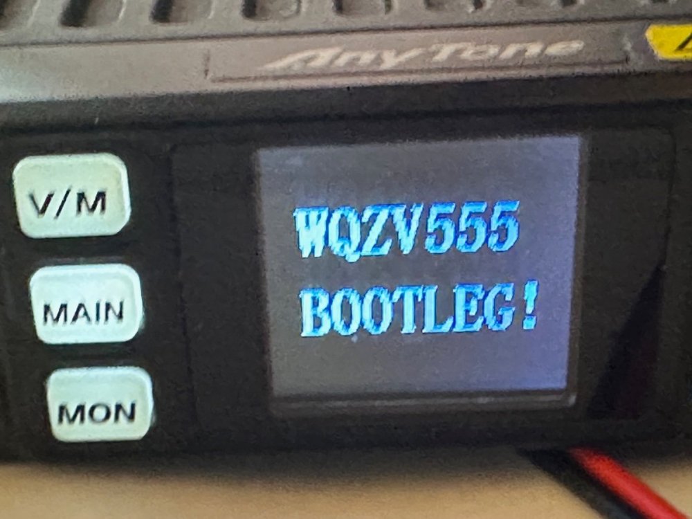

The Radioddity DB20-G a/k/a Anytone AT-779UV has a somewhat unique "hidden" feature embedded in it. When the programming cable is connected to a computer that is connected to the internet, it scans this Forum to see what comments, if any, the owner of that particular radio has made about the radio and/or its programming software. The radio then treats it owner accordingly! Those of us owners who know how to treat our radios and comment online, don't have this Define Starting Display problem! -
1) Push FUN button 2) Using the V/M button as UP and MAIN button as DOWN, go to Menu Item 29:DSPCHANNEL. Using the UP ARROW KEY (^) as UP and the DOWN ARROW KEY as DOWN, change CH to NAME. 3) Press the FUN button again to exit Menu Mode You should now be able to toggle between VFO and Channel Modes. @OffRoaderX would have told you this tip, but he was too busy being snarky to others whose only “crime” is wanting to help others on this Forum.
