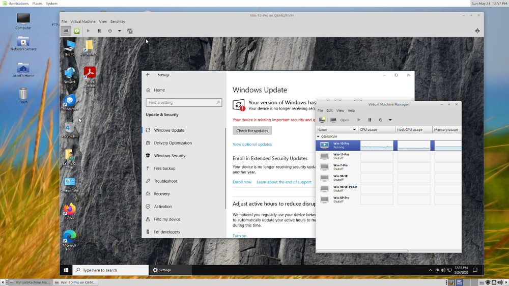

M$ screwed up with forcing a move to a tablet type interface on newer versions of Windows. Win10 is "tolerable", have it on the work computer, company laptop and home PC. I needed it on the home PC because the Kenwood license manager for their feature license installation won't work on Win7, which I would still be using otherwise, it was close to the look and feel of Win XP. The Win11 I have in a VM for experimentation sucks. It's slow and and nothing more more than a advertising delivery system for M$ garbage. I've flipped every "switch" I could find and researched on-line, but I sill get annoying reminders, here and there, to get M$ Office 365 and cloud services. Win11 is the new Vista, and much more annoying.
