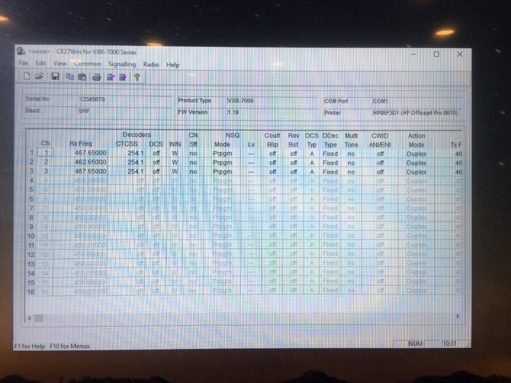

Yea i just added all those channels to show you guys that i can add channels but the actual frequency doesnt seem to be going in but when i read repeater it will say its in there

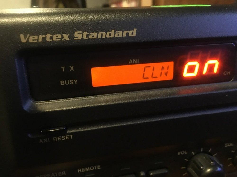

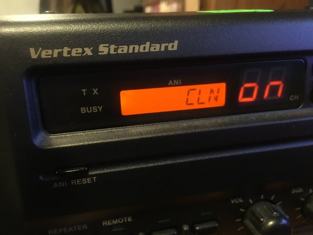

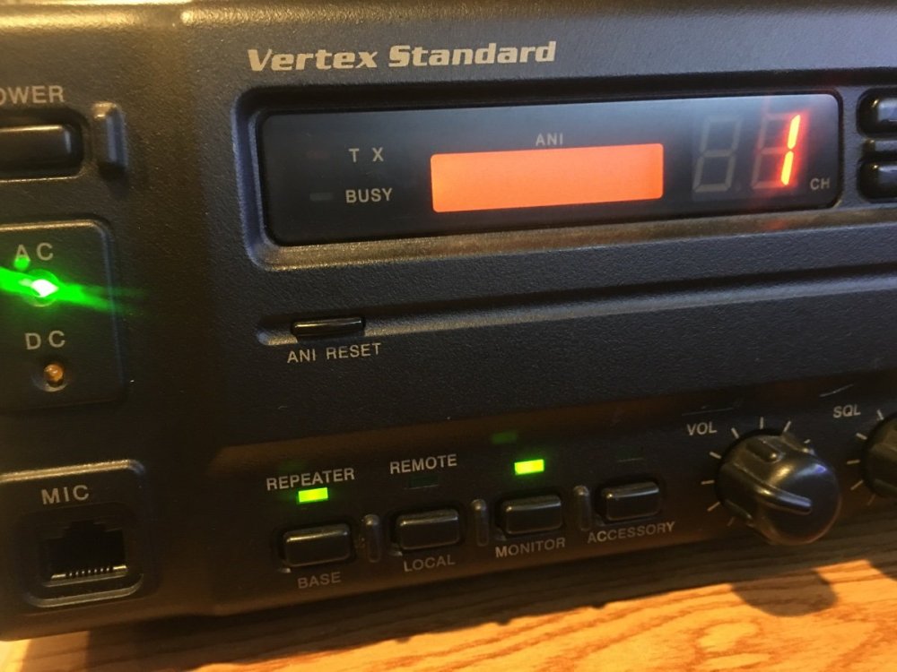

Yes , im also being told that when its plugged in the repeater should display prg on , my repeater says cln on when cable is plugged in then when im done reading or writing repeater it displays channel numbers as it should so i cant get a clear answer on the cln on or prg on thing
Yes , it displays the cln on while the cable is plugged in , i can read and write the channel numbers and when i unplug the cable and restart repeater i then can scroll through channels with the channel buttons on repeater but when i key up ht to test if frequencies went in the repeater doesn’t rx or tx so im not sure if frequencies actually are in it
This is what i see , like i said it looks like its connected to repeater cause the blue line goes across and says download or upload complete but repeater doesn’t seem to have my frequencies in in it just a channel number

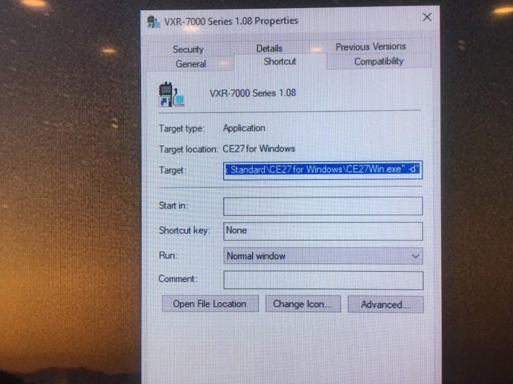

Ok appreciate that , im not home now so in the morning ill give it a try but it says v1.08 and comport working , i actually see it upload and down load on pc so i know there’s connection but i dont know if the repeater is supposed to say CLN ON when cable is plugged in , I assume that means cloning on but ill look in morning thanks man

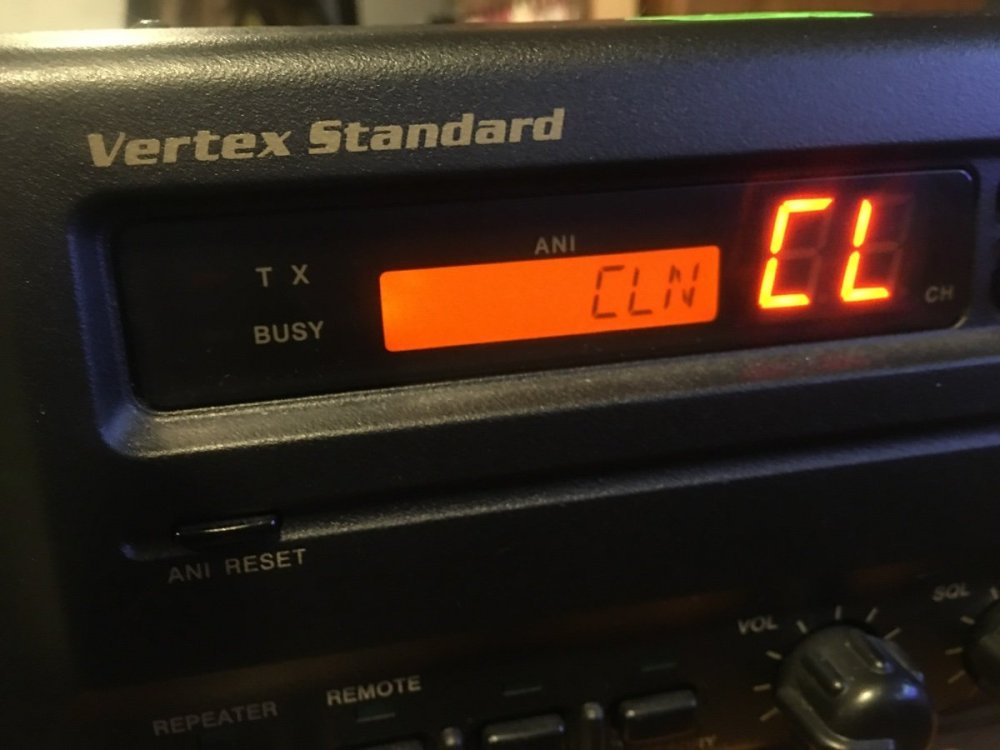

Yea tried that and no rx red light but very odd that when i write to radio and then read it it shows my frequencies are in it but its just not keying up, did yours show CL ON when you plug in the cable ?

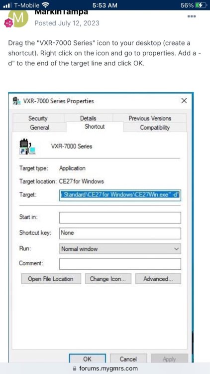

Im able to use -d” option and change from vhf to uhf , the repeater is vxr7000u. When i can send frequencies and everything to radio and then read it back to computer, my issue is when i check the repeater the only thing being displayed and changed is the channel numbers so in other words uf i send 16 channels to repeater all 16 will go in and i can use the up and down button on repeater to scroll through them but nothing displayed on screen as in alpha and even when i grab an ht and key up nothing is heard on repeater so im not sure what im missing , thanks for the help
My repeater looks like it downloads to repeater but still dont see alpha tags and when i key up radio on the frequency i hear nothing from repeater
