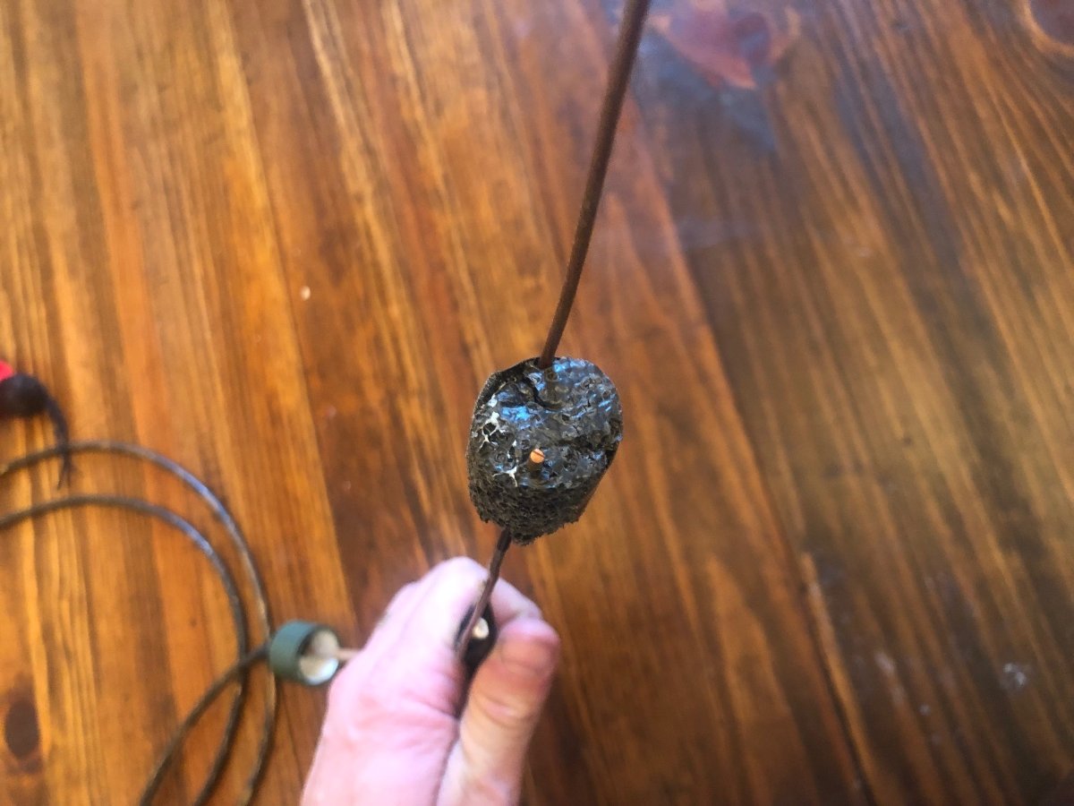

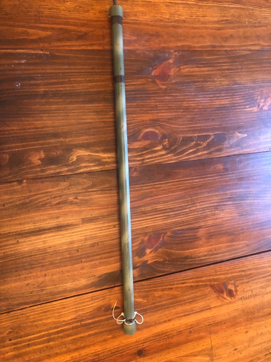

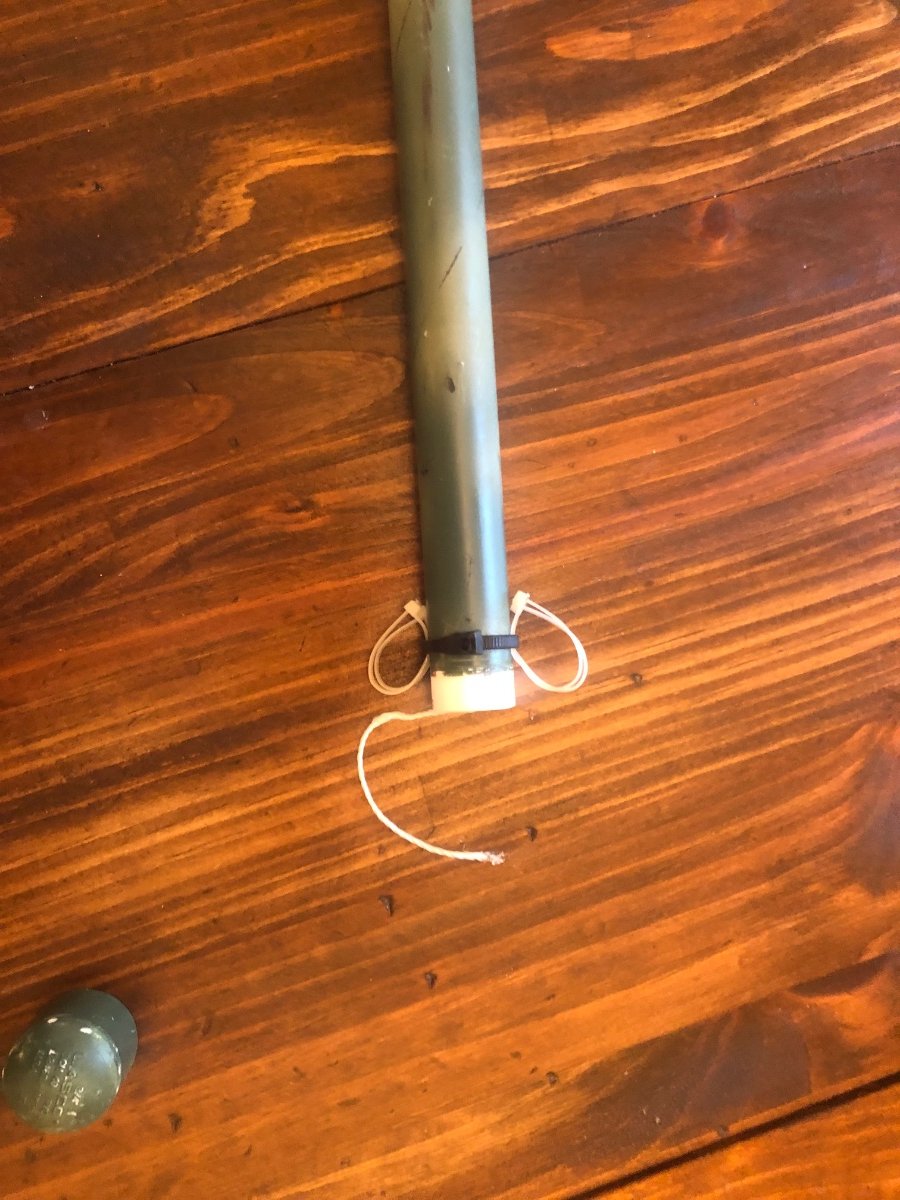

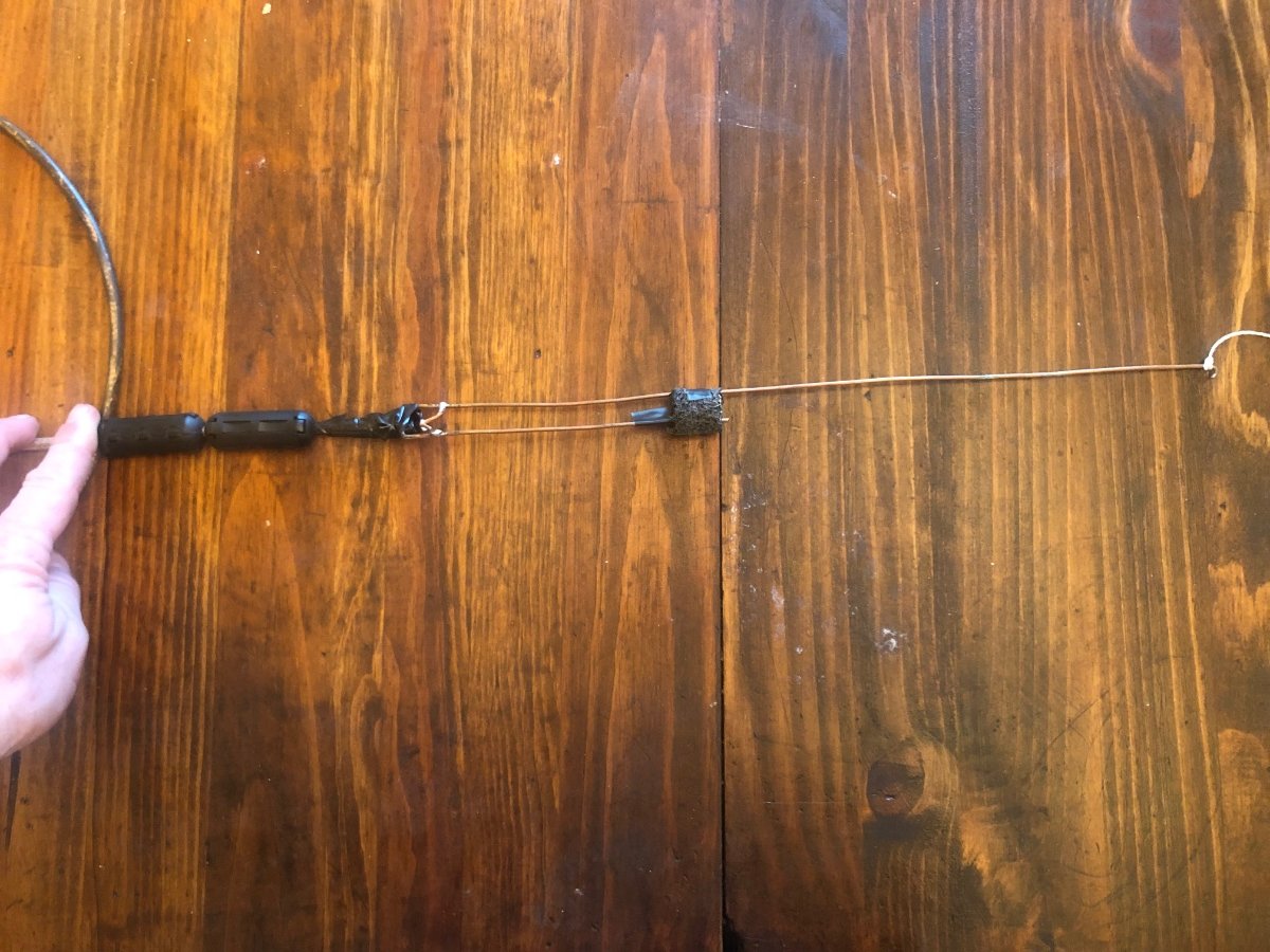

N9taxlabs makes a dual band GMRS Murs roll up jpole. Quite easy to pull it up in to a tree with a throw weight and some line.
I recommend get the 16’ cable and BNC connector options. BNC mod what ever HT you plan on using with the Jpole.
12lb test fishing line or higher will make getting the antenna into a tree easier. Tie the fishing line to your throw weight (or water bottle) heave it over a branch, cut it off the bottle and tie it to your paracord and pull it back over the branch with the antenna.
