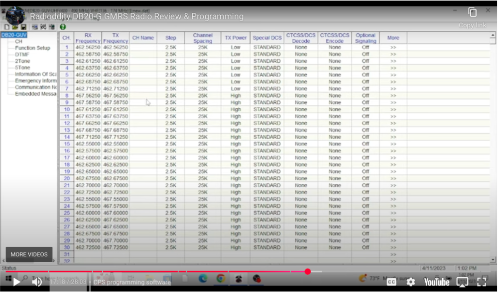

Has anyone had luck using the manufacturer’s CPS (computer programming software) with the db20g? Program allows me to download from radio, and see the entire file, but it won’t allow  me add PL tones no matter how I click the field? I’ve tried the keyboard, mouse and tried batch channel editing and nothing can be edited in the software other than the name of the channels. Am I missing something? Chirp is not supported yet with this radio far as I know.

Using the YouTube video as a reference point, at about 17:20 in, you see the Radioddity software:
If you double click on the "double caret" below the word "More" for the Channel you want to edit, it should bring up the window for changes:
Does this work for you?

Alright my guys! I will take your tips and apply them when I get a chance this evening. Thanks. I’m thinking I didn’t double click the furthest right arrow or carrot as that’s not anything like the wouxon chirp or baofeng software that I’ve used.

That’s right; the software works differently than Chirp. As others said click on the caret.
